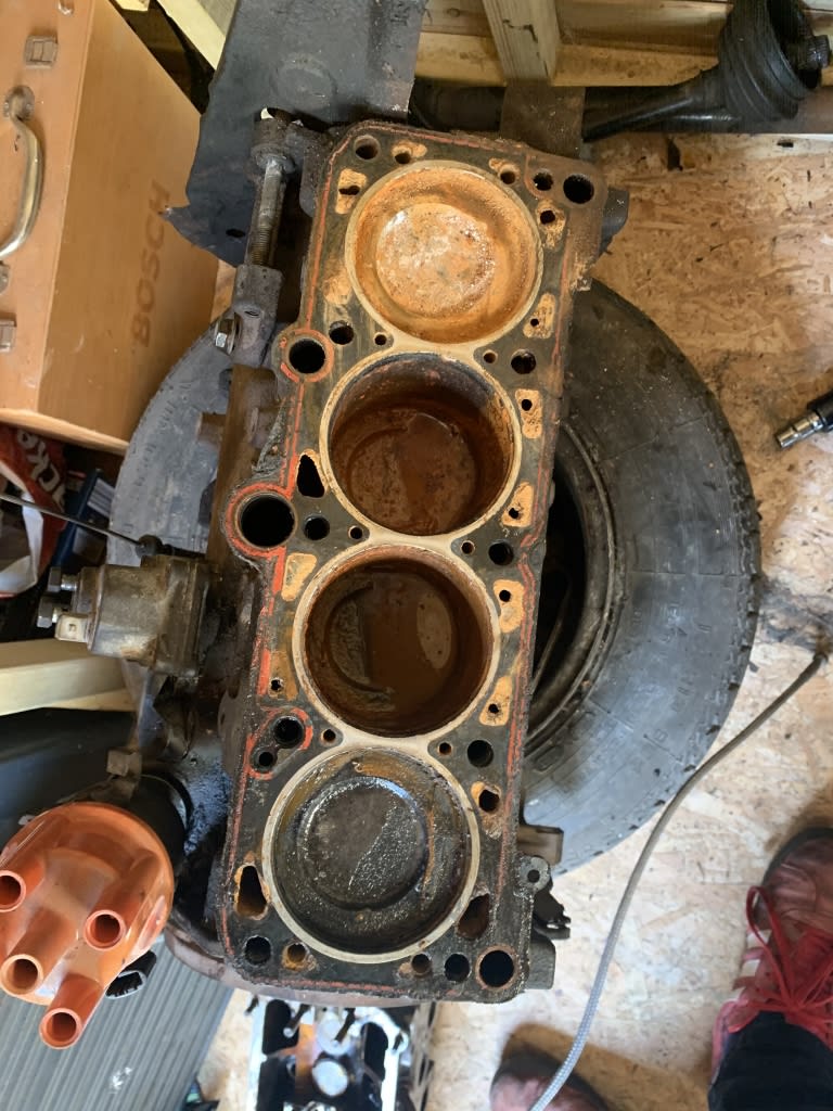

What options do I have???
#1623168
(In Topic #222222)
Rusted and seized!!! 🙄
You could source a new refurbed engine, and swap numbers on log book.
Or replant to something modern. 8

After that - as Ken said, you might get away with honing, but after that it's a rebore with new pistons and rings. At that point you could for a 1.9 rebore or just stick to oem oversize. A rebore will be ~£100, no idea what pistons are these days. Then, as you having that done, you may as well get the crank checked, possibly balance the crank and flywheel. You'll need new big-end bolts as well. I had my block redone with balancing (I had the pistons) and that set me back about £700 inc all the gaskets, shells, rings, bolts, etc.
Regional Host NE
for rust removal in my opinion
