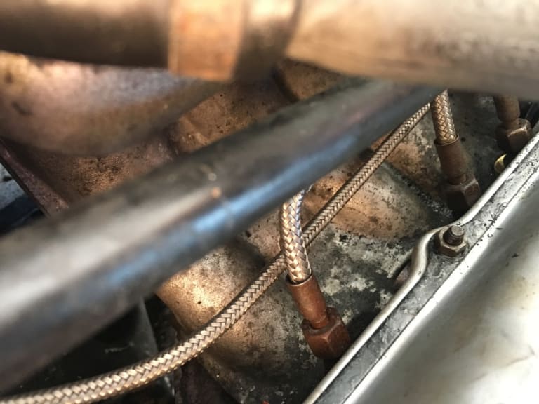

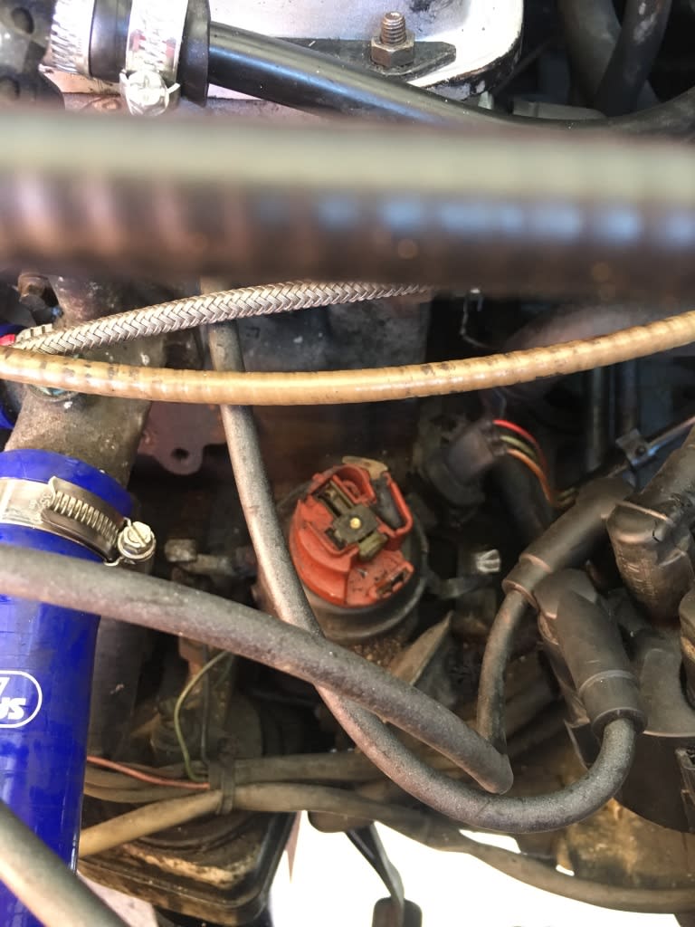

This is exactly how my head when on with my pistons at tdc. I think the valves were closed on cylinder 1 and 4. With the pistons 1 and 4 at tdc. What am I missing?? I've labelled it crudely. IMG_3845.JPG
Looks good if you marked it
