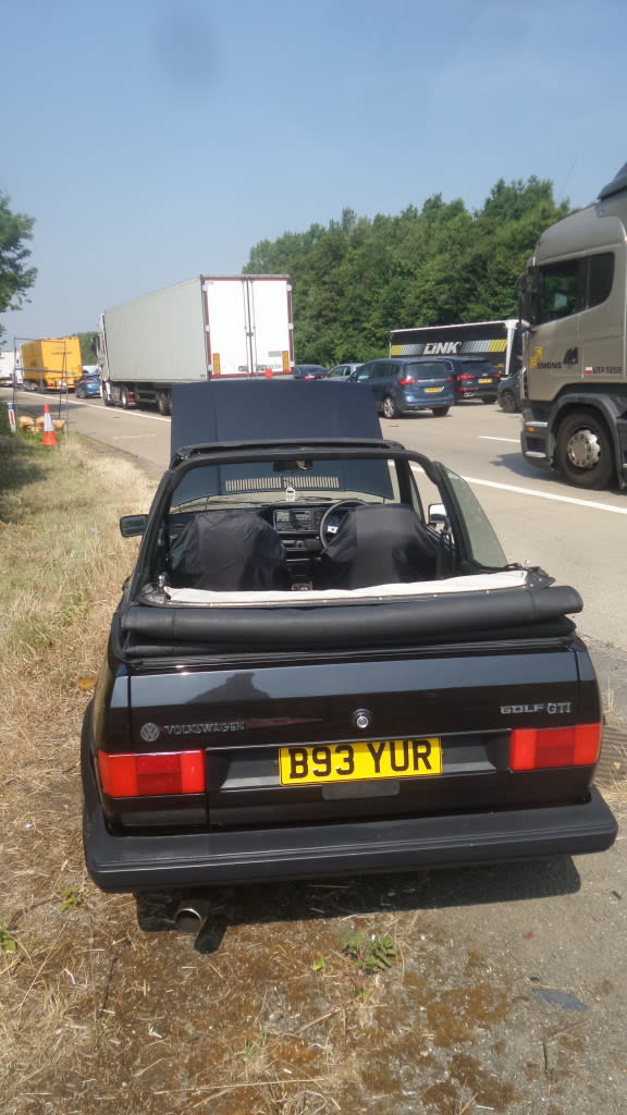

Guys I'm hoping you can help me.
Was stuck in almost standstill traffic on the motorway a few mins ago and the old girl started getting warm.
Pulled over to let her breathe for a bit and noticed the throttle pedal was flat to the floor.
Hooked it back up but now the car just starts and dies instantly
What have I done?
It must be related to the pedal, what holds the end of the cable onto the pedal apart from the shape of it?
HELP!!

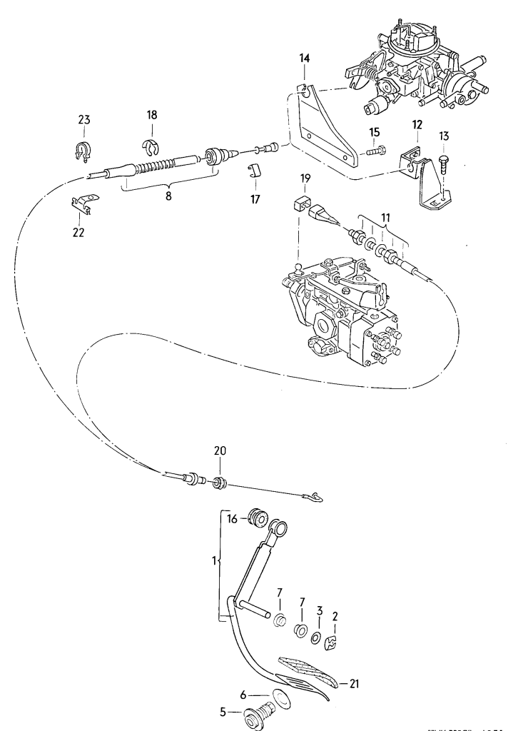

From looking under the dash it doesnt look like part 16 was ever there so how it lasted this long I'll never know.

There should be some slack in the cable, there was a guide on here about replacing and setting up the bush/cable.

You may need to smear a little grease on the bush to push it through the pedal, make sure the bend on the end of cable is at a right angle, you can bend it if it's not.
If there is not enough slack in the cable and you floor it it's the end of cable that bends and it will keep popping out of the bush.
found the thread on adjustment, you can see the foam style bush to avoid in the picture, there’s nothing wrong with the foam bush but I found they don’t last that long…..
