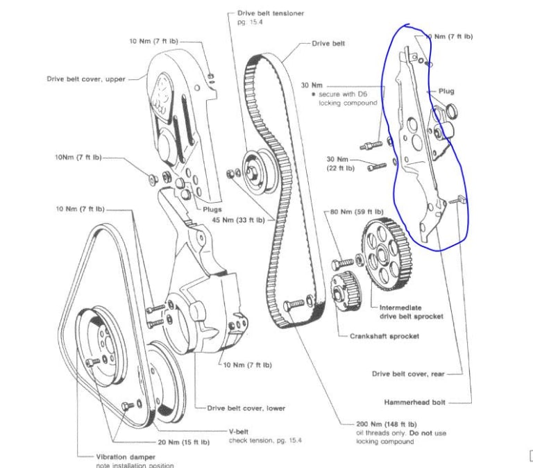

I had the same on my 1.5 JB after cam belt and tensioner replacement.
Issue was caused by the piece of sheet metal against the engine block got into a resonance and touched tension pulley.
When doing the cam belt I also replaced the seal of the intermediate shaft.
Removed the sheet metal to paint and slightly deformed it at reassembly.
I re-assembled everything keeping the clearance between the sheet and the tension pulley
==> Issue solved.
Success
Kris
How much needs to be removed before access to this sheet is available?? Looks like the majority of components?
I had the similar thing happen on my Diesel, and I was able to get a thin screwdriver and "pop" the tin back in place which caused the noise, the next time I replaced the belt I straightened the tin…. might be worth a go at it.
