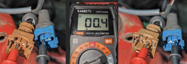

Hi,
With both CSV & TTS unplugged there should be continuity only on wire colours R/B to R/B & G/W to G/W.
In the picture I've tested on a car here, with no modifications on loom, see which side of the plug has the same coloured wires.
Testing R/B to G/W there is no continuity.
Double check that the multimeter is plugged in the same as the picture.
A wild guess is may be the plugs have been replace and for whatever reason the wires plugged back on the wrong sides.
Testing voltage on the blue CSV plug should have voltage around 12V for a few seconds when cranking.
Removing the CSV from it's inlet housing and placing in a jar, it should spray for a few seconds when cranking.
