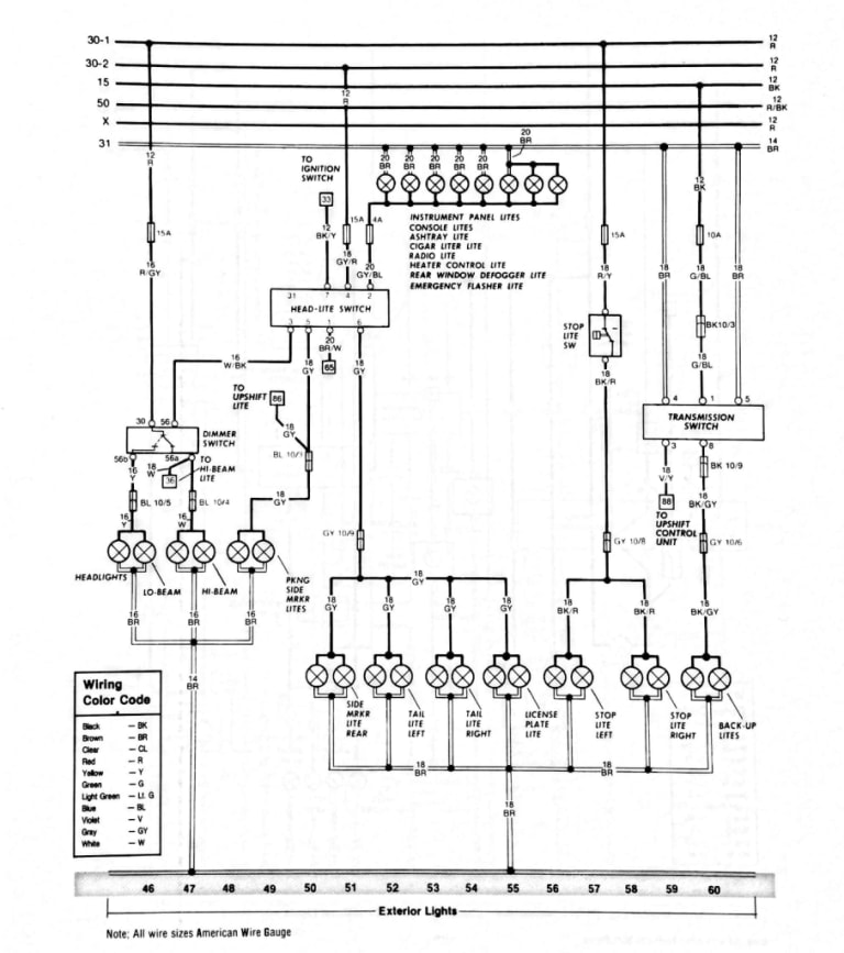

Earths Checked, but have you tested them from the bulb socket to ground (frame)?  Do you have 12V on the Positive side to ground, as you are missing something here.
The only thing that they all have in common is the Ground.  All the running  lamps work off the headlight switch.
The Stop Lights work off the Brake switch, and the reverse operate off the reverse switch on the Transmission.
All of them have separate fuses, so you either have no voltage from separate paths or no ground.
 Thank you. How do I test the bulb to ground? Are there any other earth to check/clean? Where are all the switches you mention, maybe something is unplugged ?
