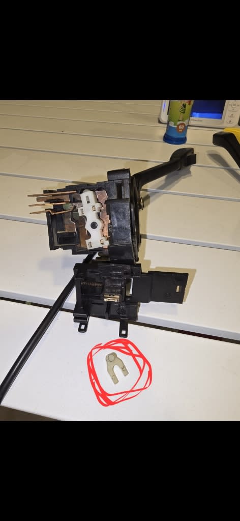

I need some help assembling my high beam wiper stalk.
I was trying to replace the ignition switch on my mk1 cabriolet 89 and while removing the wiper stalk it became 2 pieces and things flew out.

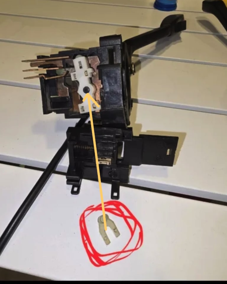

I have managed to assemble most of it. I don't know where the white small hook goes which decides if the high beam is on or off.
Now my lights are stuck to high beam on.
Anyone knows where that white plastic goes to? [
If you look at the white horse shoe it has 3 distinctive rub marks, and I would bet that if you got it apart again you would see they isolate the two plates. The Copper plates will have shiny areas where the things are rubbing against it.
all sorted now.
