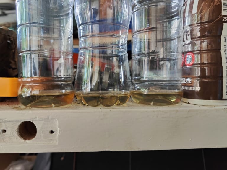

Fuel injectors spray out fuel in roughly equal measures
