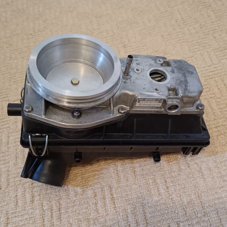

You'll be able to see an air filter sitting in the lower airbox part, there's none in my images.
Once undone the control unit and its plastic base can be raised away from the airbox (which is fixed to the inner wing), though with the fuel lines / rubber hose still attached it'll limit just how far up you can go.

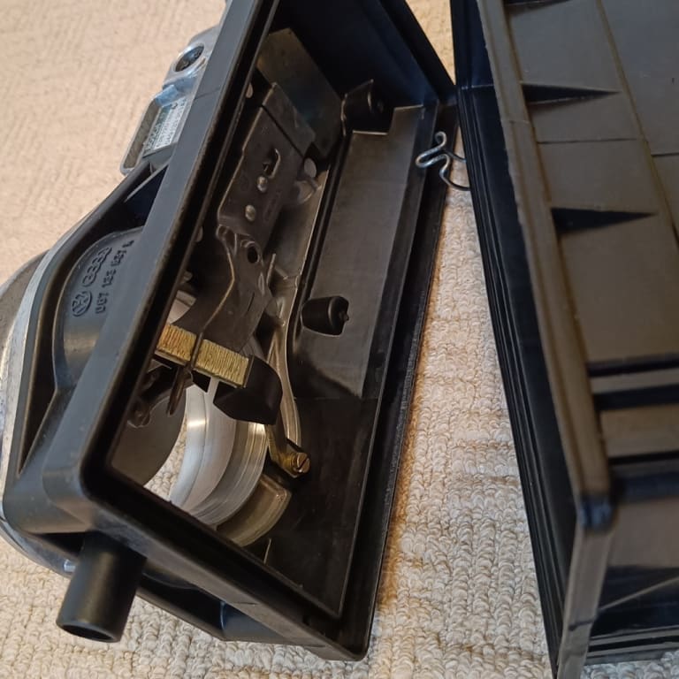

Depending on how much of a gap you can create without stressing the fuel lines etc. you should be able to see the underside of the unit.
The arm with the airflow sensor plate will probably fall open because of gravity as you tip things to one side which will obsure the parts you want to see.
So it'll be awkward, but if you keep the larger arm down you should be able to see the smaller arm within it and inturn a portion of the screw if it's there.
If it's not, the liklihood that the small arm will be able to move up and down independant of the large arm will in itself confirm the screw is missing / broken / something else is amiss.
