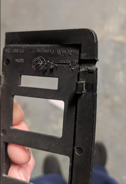

On my Blue Tooth that had the external Mic, I routed it behind the Dash and placed it on the edge of the Drivers side door of the dash, I filed out the area needed for the cable in the headlight housing of the beezel and the cover plate with a hand file and affixed it to the side of the dash with 3m weather stripping tape. It kept it on my Cabriolet out of the wind.
