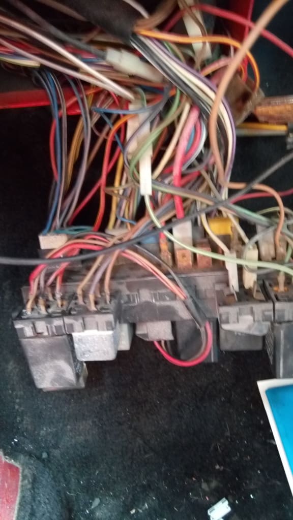

My next issue is puzzling me I have gone to refit number plate lights and whilst they were on I put the fitting back into the body and touched a connection on the body and they both went out !!! Fuse is all ok but I can't get them back on at all !!! What has happened im baffled
However I've got the back of the fusebox exposed and there seems to be a bit of corrosion lurking! I've cleaned all the earth cluster but omg where do you start with the rest ???

Sorry it's ok only melted the plastic cover over the spade connection! I could do with one of those not sure they are available
