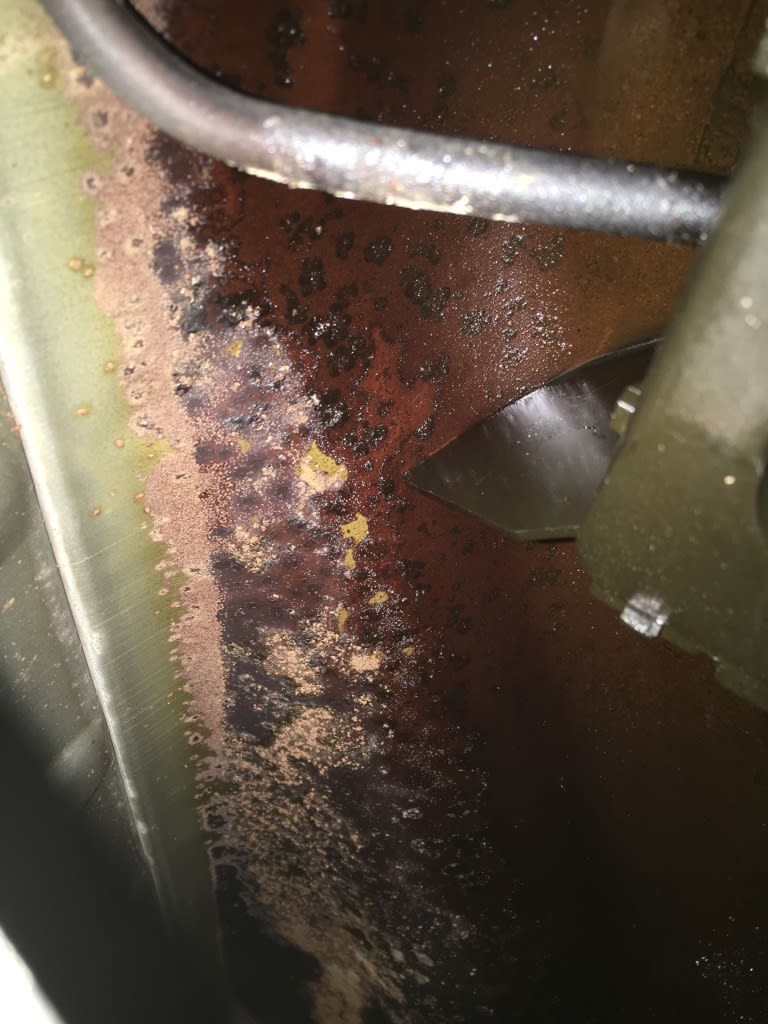

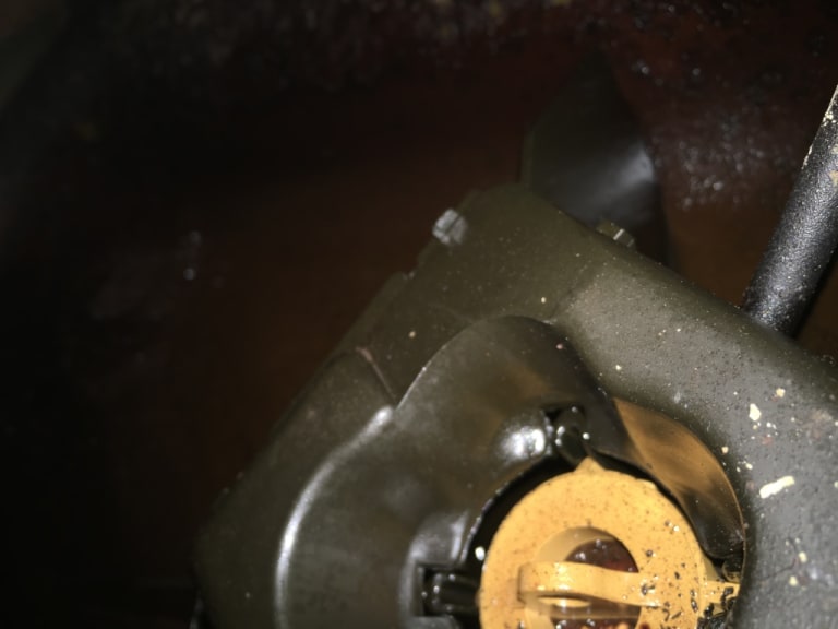

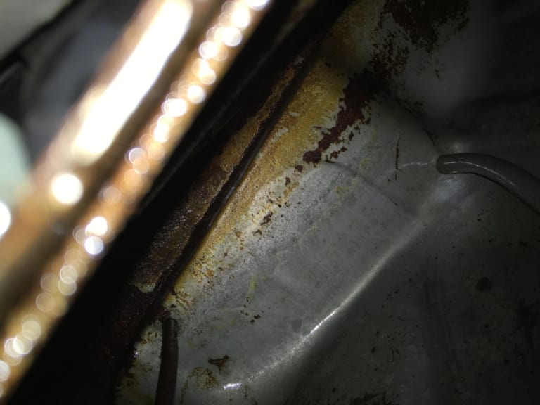

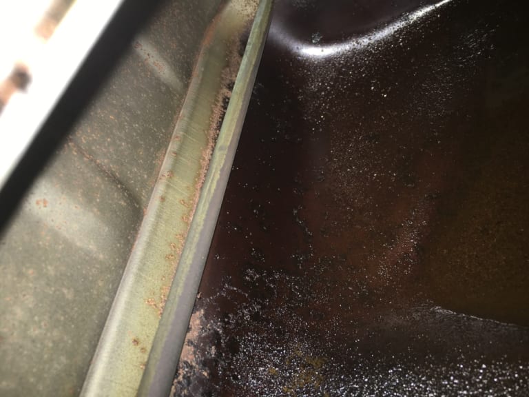

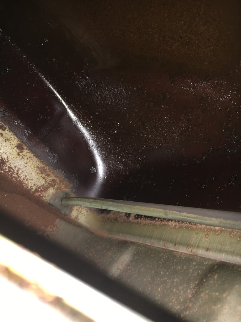

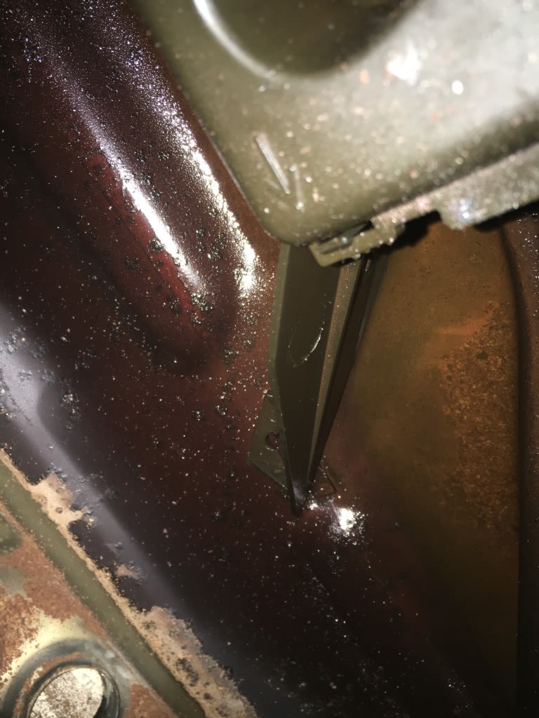

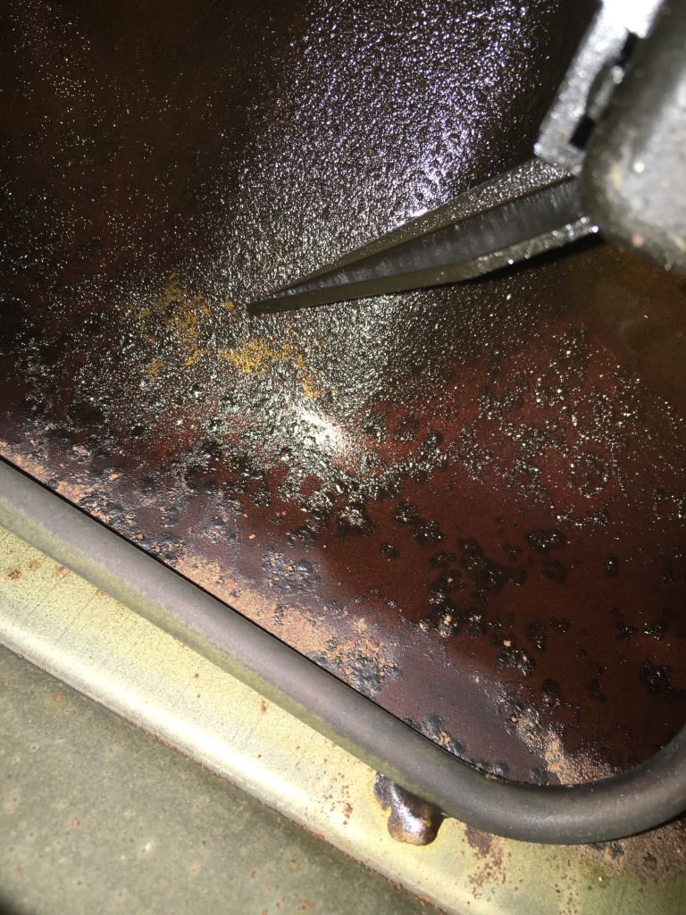

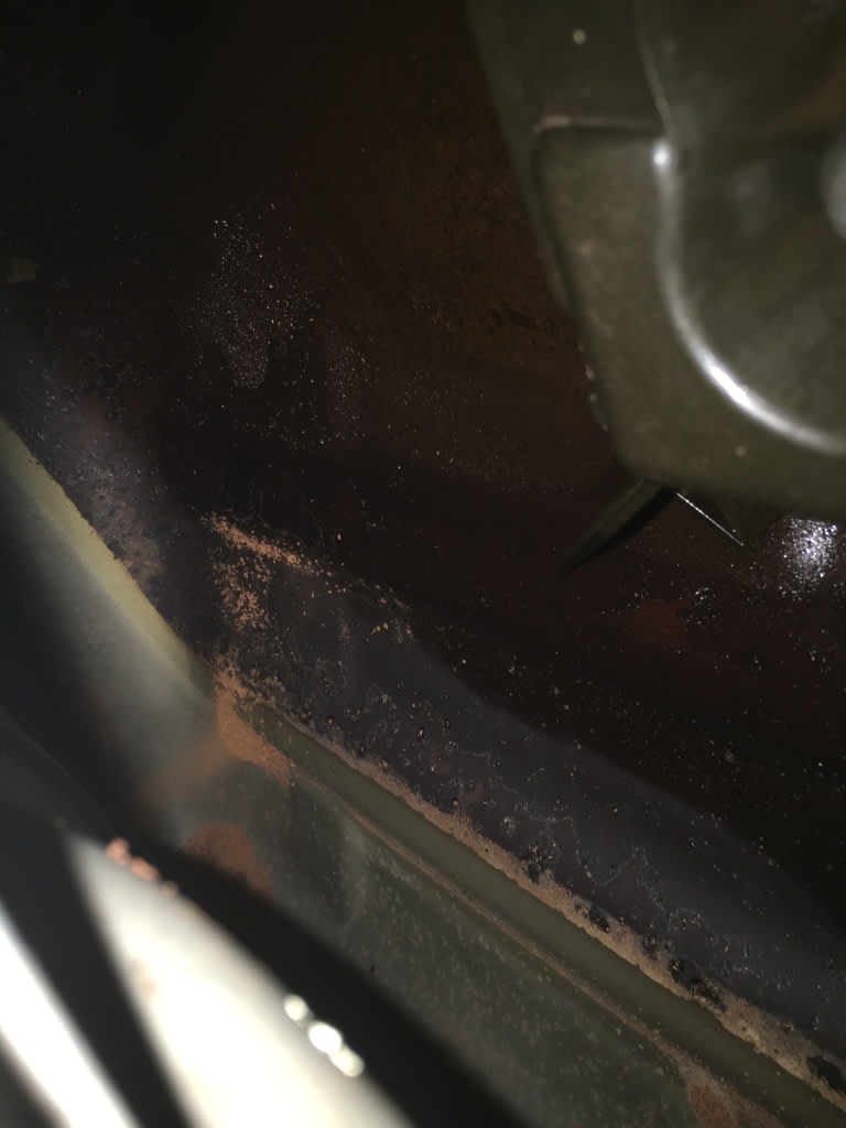

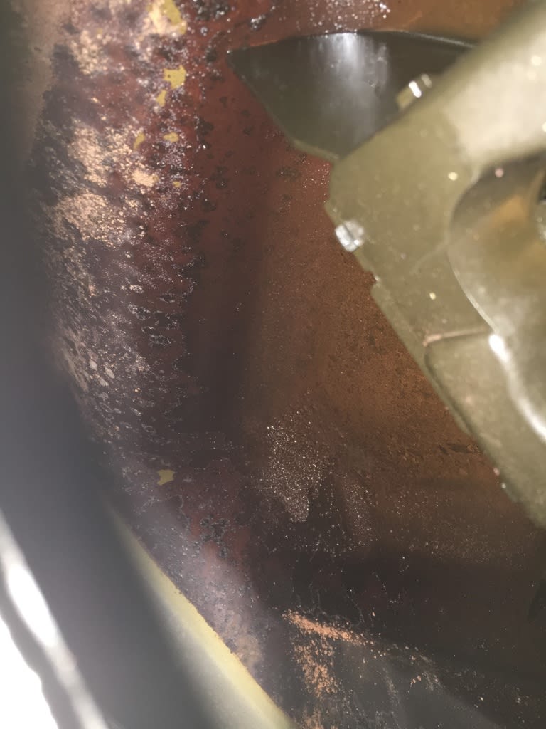

Would you take the chance ?? This is the best pictures I could get
Normally rust is the issue but that looks different - it looks like the gummed-up residue from old petrol. If it is that, then its going to be constantly producing bits of jelly held in suspension with the petrol, for weeks/months of running. So I'd be tempted to try and clean it out. As far as rust goes, I can't see much (any) so you may be okay there. The best thing to clean it out is probably petrol anyway (and this also much simplifies things) but you'd need to get some kind of cloth that doesn't dissolve in the fuel to physically wipe the tank inside surface clean. I suspect this would be easier with the tank out but might not be too hard with it in.
