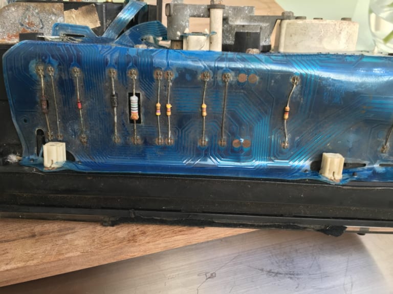

The smoke came from another part of the clocks where the blue plastic which contains the copper wires, came in contact with another part of the blue plastic, which caused the smoke
I have got a picture of this part but not sure how to upload.
Gary
Which specific Traces on the mylar burnt, I see a couple that may be them. The issue is that as our car ages the mylar is taking the worst for it as it is becoming Brittle and delaminating….so you have to be very careful of bending it and things.
Be very careful with what you clean it with, for the copper pads a q-tip or cotton swap moist with alcohol is best.
An eraser (pencil) will shine them, but may also lift the traces. Great Care must be taken.

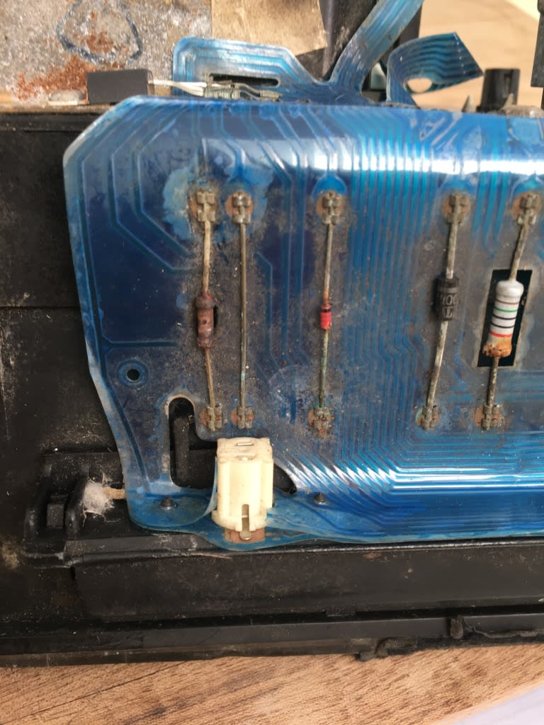

This was the part that I thought had come in contact with one another hence the smoke
But seems it may have come from elsewhere
Take the nuts off the gauges and clean them with sandy paper to get them bright and shiney. Take Steel Wool and use it to clean the screw posts…and to slightly brighten the mylar pads. Reconnect the nuts and tighten not overly tight snug……
inside of the fuel gauge where the wires go to the studs can get cold soldered and stop it from workign or working intermittently.
inside shot of the Fuel and Water gauge….
I would start looking for an instrument cluster. The Crimp connections on the mylar are all corroded, and need to be resolved. Trying to splice a new resistor in for the place of the old one isn't a easy task, and I don't know the value of the resistor in question….
