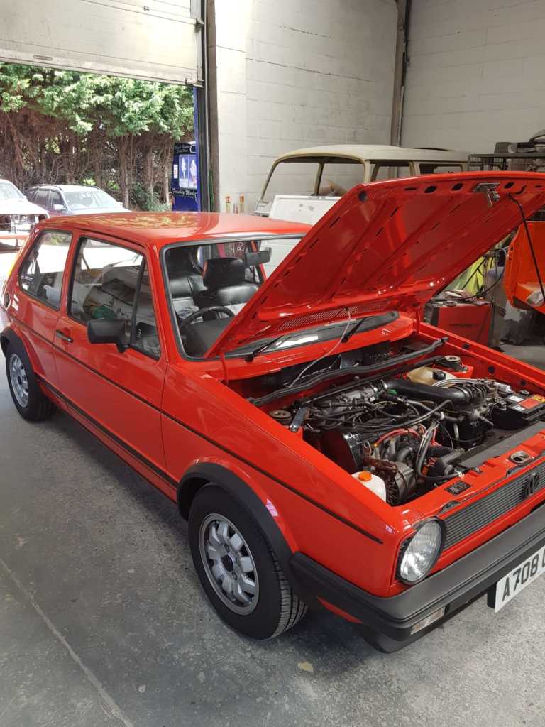

Hello, need some advice. I have a 1983 Mk1 golf gti which I have only owned for a few weeks, the problem I've got is when I accelerate the car becomes very unstable and hard to control, it feels like it's swaying. I've checked everything and cannot see anything wrong. I've had alignment checked, engine mounts. It's got terrible coilovers on which don't help, I've had a few mk1's so know how they should handle but this one is all over the place at speed, it's got upper and lower strut braces which I thought improved handling! it has been restored and put back together, pretty much new everything, it's driving me crazy as I cannot drive it as I feels like m going to come off the road. can coilovers break but still look in tact? any advice would be great fully appreciated. cheers Andy
