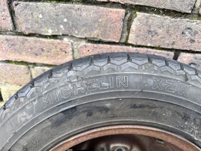

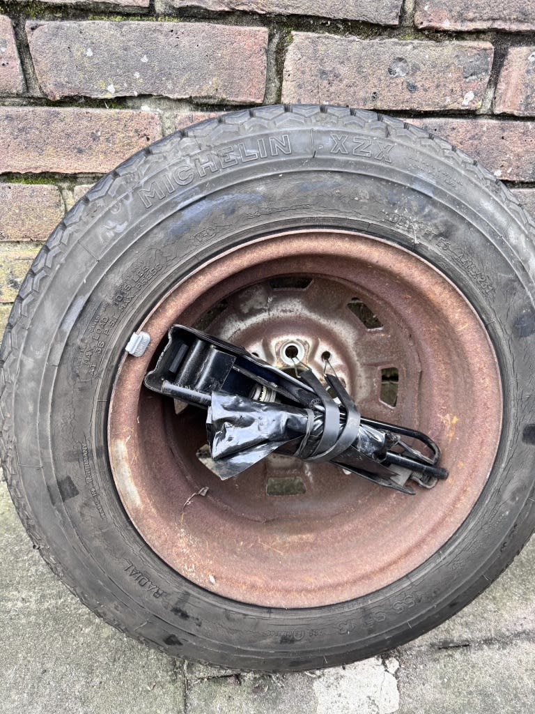

You know what I've pulled my spare wheel out and it has its original tyre on it surprisingly, it's a Mitchelin Xzx, 155sr13
I can only seem to find 165sr13 tyres do you know if these will these fit at all without changing the overall diameter ?
Good old Michelin XZX, my favourite tyre in the 1980s. The date code on the tyre is 231, which I assume is Week 23 of 1981, nearly 44 years old!
The 155R size suggests the rim size is 5J. The closest low profile tyre would be 175/70R, which is the tyre VW fitted to 5.5J rims. Personally, I'd stick with 155R if you can.
There is good availability of modern 155R13 tyres (nowadays described as 155/80R13). There are also a few classic repro tyres in this size, eg Pirelli CA67
Wow thank you for that insight my car is indeed a 1981 so that would be right. I love finding little things like this about my little golfie it always makes me smile
I don't think I will be relying on this as a spare anytime soon haha 😎
