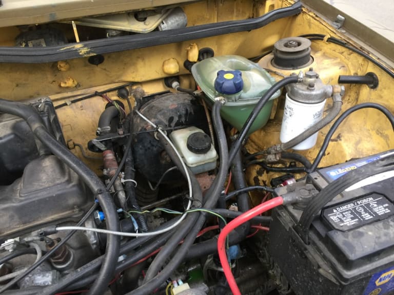

Do you have a top fill radiator or an expansion tank near the brake master cyinder?

I have a little plastic jug of coolant over the driver side wheel…
