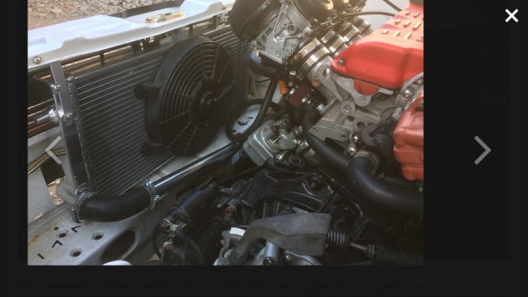

I've gone with a top fill rad and push fan from ebay
A 12" fits on the radiator and under the slam panel thus meaning it's completely out of the way.
I did have to switch the wiring as it was pulling not pushing for some odd reason but apart from that works well.
