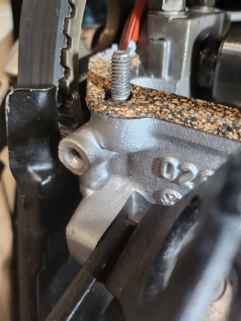

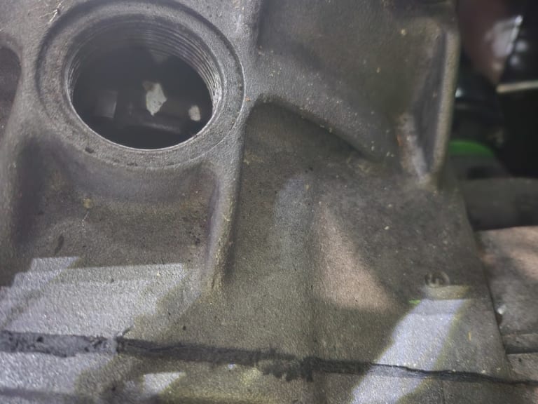

Can someone confirm I'm not getting mistaken here as I've got a new built engine with the project I purchased which isn't firing up on a 1983 DX Gti
I'm checking the static timing first and with the cam mark lined upto the head, valves correct and at TDC, its lining up with the mark on the flywheel to the Diamond cut out not the dimple.
Other posts point to this being incorrect, should I remove the belt and align the marks to the dimple
Thank you
Following this i need to remove the cam belt and time it to the dimple on the flywheel as i thought, and ensure the dot on the cambelt pulley is level with the top of the valve cover.

I always set mine using the timing mark on the crank pulley not the flywheel.
mark1gls said
There's also a timing mark on the crank pulley and intermittent shaft, see pictures in this post.
https://vwgolfmk1.org.uk/forum/index.php?page=topicview&id=big-block-injection_2%2F-help-confused-timing
Also worth dripping some oil over the cam shaft lobs.
Before starting for the 1st time remove the rotor arm or dissy cap and crank over the engine till the oil light goes out, then you would of built up oil pressure before starting.
Good luck
paceman said
This is a very detailed guide https://vwgolfmk1.org.uk/forum/index.php?page=topicview&id=how-to_2%2Fguide-setting-your-cam_2
Thanks both
Unfortunately there is no notch on the crank pulley as its a new one (not an original) so the flywheel is the only mark
Will do re the oil thanks Mark
I have never bothered with aligning the crank to the intermediate pulley as the crank at 0 dimple on the cam even with the valve cover tin, not the rebar. and the rotor of the diz is in the middle of the hash.
Briano1234 said
check your diz as the rotor should point to plug for cylinder 1 and be in the middle of the hash stamped on the side frame of the diz.
Morning Briano
Thanks I checked the dizzy and looks correct to me, notch is pointing to nr 1 cylinder(cambelt side) at about 10 oclock and rotary arm lined up in centre of notch
(I did notice from other posts the dizzy notch pointing towards nr 4 cylinder which is confusing me)
All marks line up so its seeming they have timed it to the flywheels diamond cutout and not the 0 dimple.
