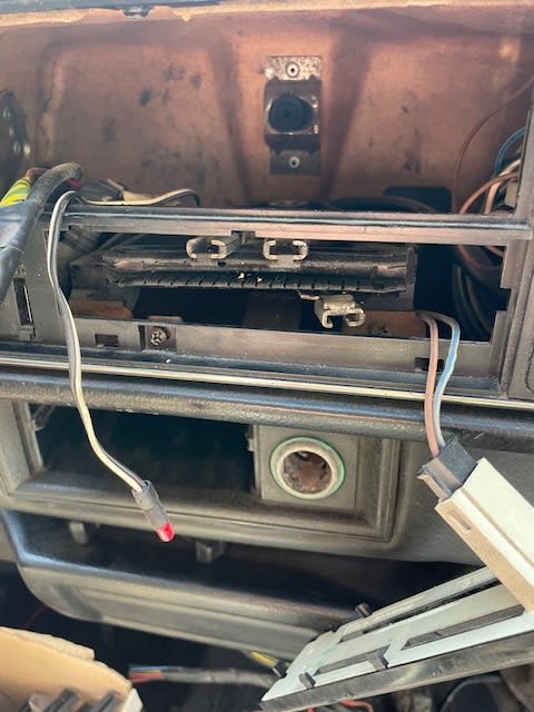

When I move the temperature control in the dashboard it doesn't move the heater control valve in engine bay. I can move the valve manually from engine bay- so pretty sure the valve is ok. I'm thinking the cable has maybe became detached in the dash somewhere- can this be checked without taking the dashboard out? And could the cable therefore be replaced without removing the dashboard?

There is also the main pivot that has a clip that can break, and cause the arms to move but not pull the Cable.

Does the heater control panel pop out?
Last edit: by KPCabrio
Then you can see the arm movement and if it is pulling the wire in the center of the sheath.
Be it also known that a 80 Porsche 944 heater control valve non-Vacuum one is more like the original heater valve on the late 70's and 80's Rabbits/Golfs that were a gate valve and less resistive to change, then the remade newer style that is way stiffer to move than the Gated Valve, and one I personally hate as I have had them blow apart leak when new.

Is it a new cable?
If I take the full surround off I should be able to replace that cable?
Any idea what that little red light is ?
thanks.
If the control doesn't slide easily then remove the assembly, and see if it is broken, then clean it and lube it with white lithium grease.
