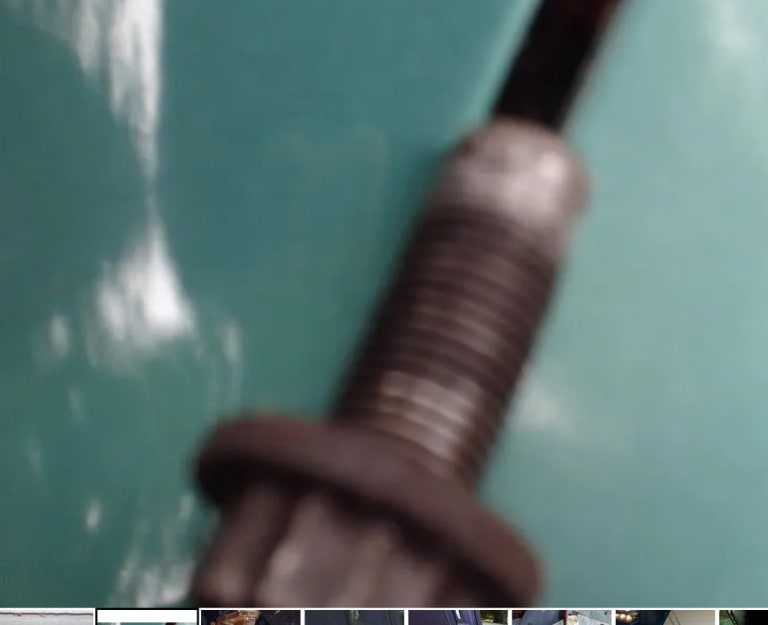

Needless to say that the Previous Owners Service Person (POS) who replaced the timing belt over torque. the crank bolt (12pt) to over 110 pounds which forced it to the end inside of the crank and bent the tip about 5 degrees.Ruining the crank. Had to Drop the Crank with the seal carriers, out. Took to a machine shop to salvage it… WRONG.  It took them with a 1 inch  pneumatic impact wrench 260 to 300 PSI to remove it. while it didn't shear, it did back out enough for the cam gear to slip over the keeper. Couldn't wrap my head around what I was seeing with a timing light.  Occasionally I  too have crainialrectumitius.
So just so you don't get snookered.
Sorry for the bad pic, but it was a 1mP camera.
Last edit: by Briano1234
