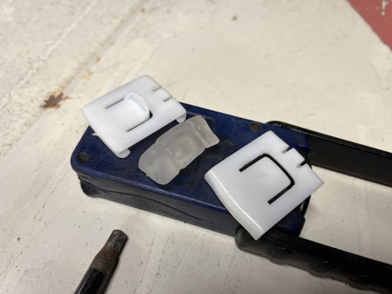

Sliders on the front seat runners - which way around do they go ?
#1678022
(In Topic #244534)

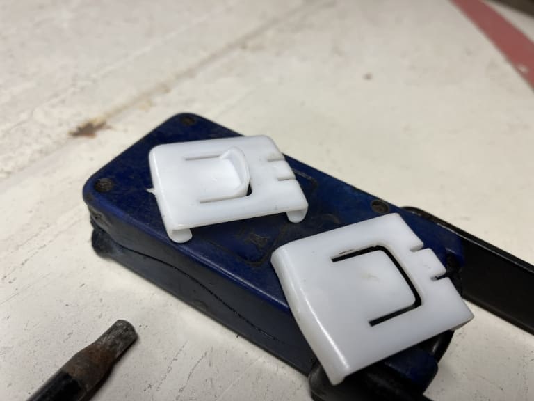

one has a bit sticking out and one doesn’t , which. way around do they go? Does the one with the sticky out bit go on the outside runner or the inside runner - ie seat belt stalk side, or doesn’t it matter ? Cheers.
https://www.volkswagenownersclub.com/threads/cabriolet-rabbit-seat-rocks-and-hard-to-slide.32197/
Hint, the winged one goes on the door rail where as the smooth one usually is on the inner rail.
Clean and Shine the catch rod, and glean out seat slide use clean grease on the slider as well as the catch pins.
I also grease the slide rails
