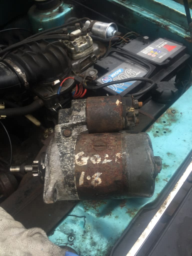

Sorry you're right I should have listed everything carried out, I actually found the starter motor has burnt out & caused a massive amp drain so looks like that's the non start issue initially thought my battery was giving up, hopefully rebuilding the starter this week, I've removed accumulator & pump replaced lines between both and cleaned out the whole system & brimmed with premium unleaded plus a new fuel filter, I will update when I get a good starter motor on it, the injectors were visually rusted from the outside from sitting for so long so hopefully that's all, valve timing is spot on and it is points & condenser but has good spark & brand new plugs, it doesn't have the timing mark like my clipper on the distributor is it just line the rotor arm with the 3 pin plug?

Just got my starter back home now so need to give it a go when I get the time, wouldn't think it was the same one that came out of the car would ya! Going to check in the bellhousing that it's not too full of crud and clean all electrical connections and give it a go!volkswarren said
