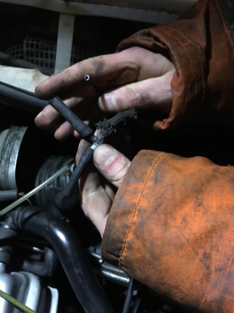

IMG_4175.JPG Yeah that's my first port of call mate. I'm having a go at that first.

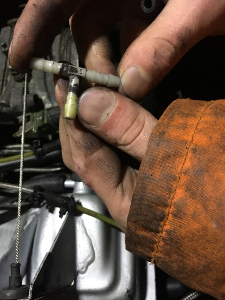

I've got this off but seems to be blocked at the centre part where they all connect. Is it supposed to be? It seems like a diaphragm of some sort.  IMG_4176.JPG
Looks like a standard T piece to me matey, shouldn't be blocked.
When I got my 1.8GTI running it was all over the place as well and I had a lot of vacuum leaks. Those small rubber hoses you pictured, mine looked a bit ropey and frayed like yours and inside they were perished so I replaced them. There is a few of them as they go down to the vacuum advance on the distributor as well. Also check the idle adjustment screw, there is a rubber o-ring on there that goes hard and leaks causing idle speed issues. Also check your breather pipes, mine had small cracks where they joined the rocker cover which also caused idle issues.

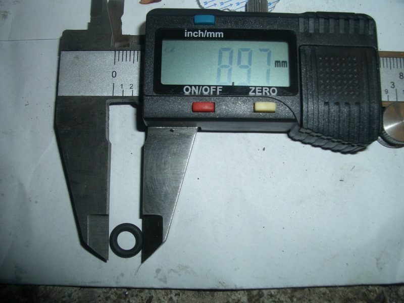

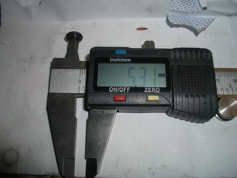

Approx size of the o ring, it's a bit tricky measuring a rubber ring.  :lol:
Outside diameter
Inside diameter.
