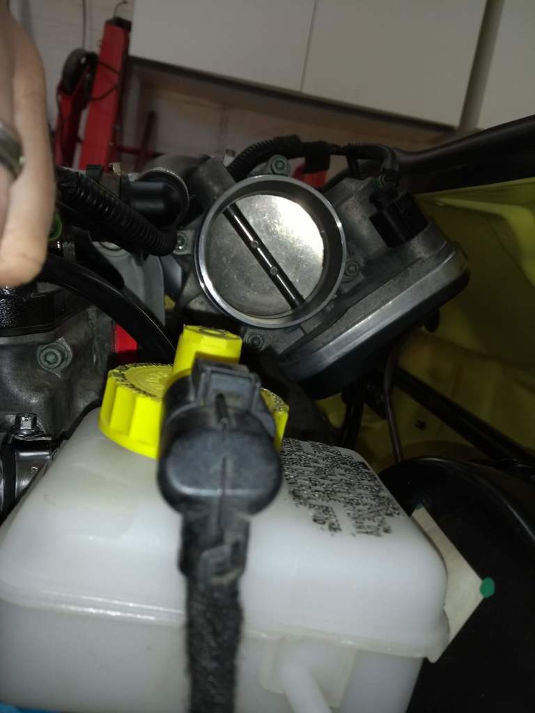

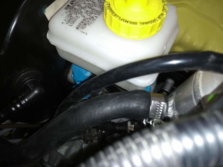

Hi Paul in my situation it's right in the way of everything
I had removed the brake bar and the power assistance and have the master cylinder connected straight to the brake pedal. (Before any one goes nuts it's the way the mk1 polo does it) The idea in the beginning was to mount it out of the way due to bike carbs catching it.
After a bit of research I couldn't find anything and mocked up some stuff but eventually went to the scrappy and got a load of reservoirs of different sizes and shapes. I found a Rover 25 one fitted the M/C and due to the shape missed the carbs.

Hi Paul,
Thanks for the suggestion. There really is quite a bit going on between the coolant reservoir and master cylinder and don't want engine movement causing any contact.
I have measured the existing barbs on the reservoir and the non barb section is 13mm and barb 15 to 16mm.
I can't trust the accuracy of the after market part so have have purchased 2 types of 90 degree barb and then clear hose to the reservoir that i will mount near by (most likely above the brake servo bracket).
I'll get some photos up when I have a working solution. I'll try to keep my current reservoir as it's quite compact.
