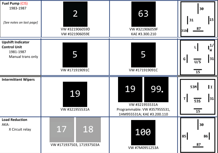

Anyone got pointer where best to buy them from as get the odd one but doesn't look like I get all 4 🤔
MK1 Golf GTi Campaign:Alpine White, Vauxhall Omega MV6, Alpina B10 3.3 Touring, Dolomite Sprint, MG ZT V6, Volvo T5 R estate
Also posting the year and fuel type (Carb, CIS, CIS-E) would also help us as well.
Problem I've got is that 3 of them are missing so can't get actual part nos.
One I defo need is the hazard/indicator relay
Also I need the fuel pump relay (no.19 I think) as mine is faulty.

I've bought a second hand fuse board complete with relays and fuses so hopefully I should be able to make progress👍
