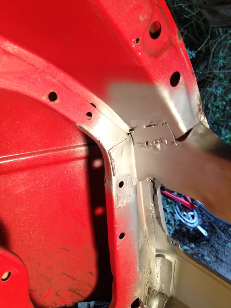

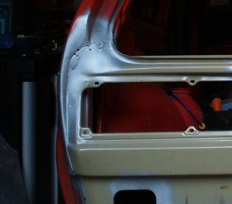

First off you can see from the outside on the top corner where it's a bit messy - I still need to tidy this.
…and from the inside, you can see the little plate I welded on - it's not pretty so will need tidying, plus there's still a bit of a whole to fill
Maybe these will be jobs I'll leave for the body shop to do - when it eventually gets there!!
It confirms that my panel is the same as yours with the tabs on the inside of the new panel that land on the inside of the C pillar bit.
You've also got the little strengthening tabs in there still to so that's good.
