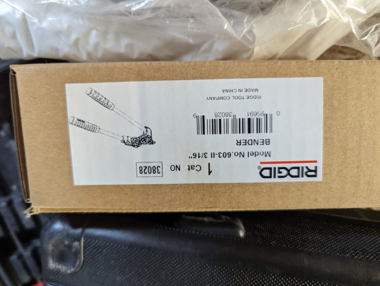

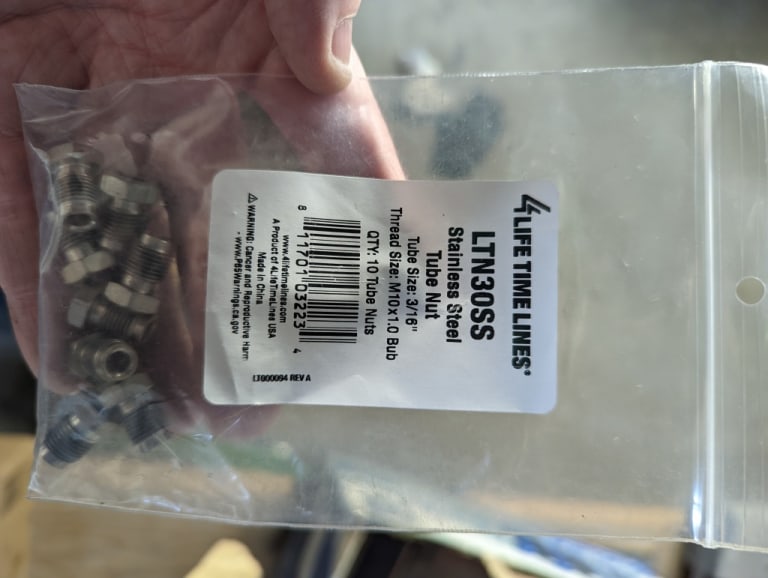

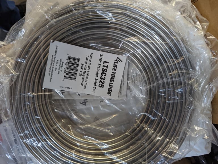

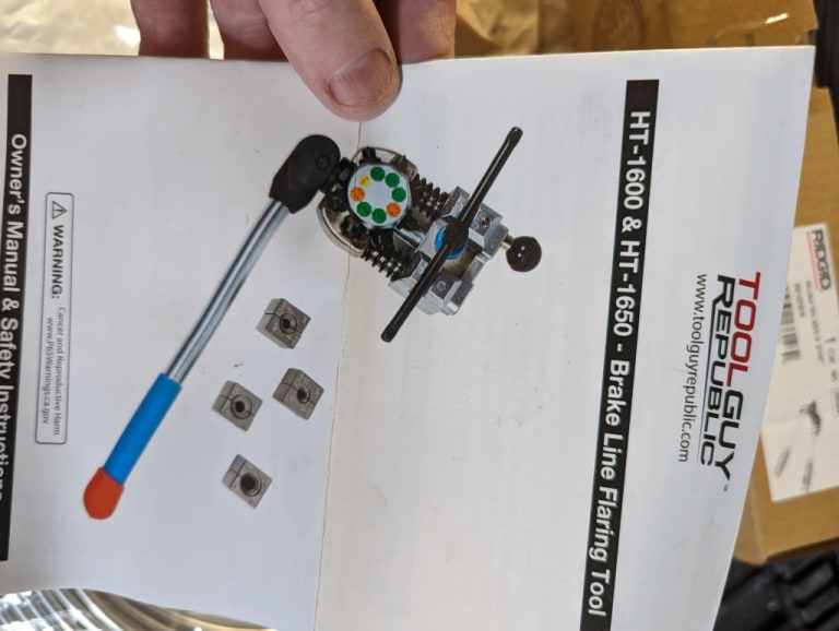

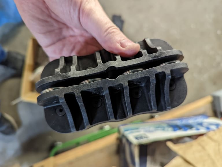

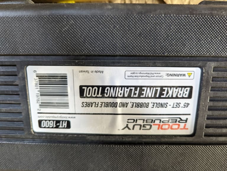

You can buy pre-made lines. I Specifically wanted stainless brakes lines for my cabriolets and to buy those kits is super expensive. So I went a different route. I bought marine grade stainless tube (25ft) rolls of 3/16" and then bought the nuts separately and then made up my own lines. It's fairly easy to do just time consuming and takes patience to make them and bend them to same shape as old ones. You would also need a flaring tool, straightening tool, bending tool to do everything. I bought all on Amazon. Bought a more expensive flaring tool and benders because reviews for the cheaper ones stated they were not good for stainless. Biggest cost was the tools. But I will use it more than once so worth while for me. I have several cars to do. I also bought the premade stainless braided hoses. They are cheap.
Im in USA so might be different in UK.
