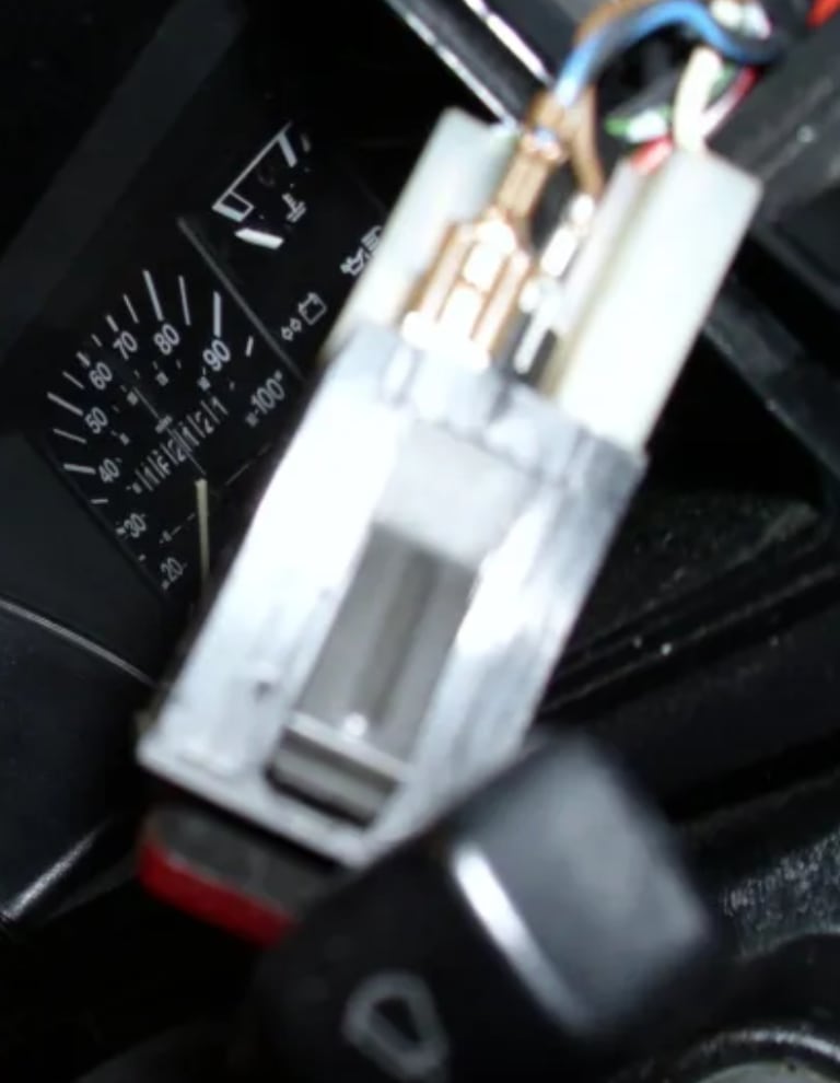

There are 2 fuses in the turns. A low numbered one for the Hazards f4, and a higher numbered one f19 for the turns.
On the back of the hazard switch there is a single bare Spad connector (thin) that if you short it to ground it takes out the higher numbered fuse. When that fuse goes the lamp but glows. And you can short it on when you put it back in, or have the bare wire dangling about as you work on something else… To quote the immortal Forrest Gump "It Happens!" at the end of that scene you see a t-shirt with this on it
To fix it from happening again, take some heat shrink and insulate that connector.

Aha some kind person had taken the blue/black wire off the switch, put two tap in connectors on and dropped it into the bottom of the heater controls. Refitted it, took the tapins off, sleeved the wire where the insulation has been ripped off..jobs a goodun.

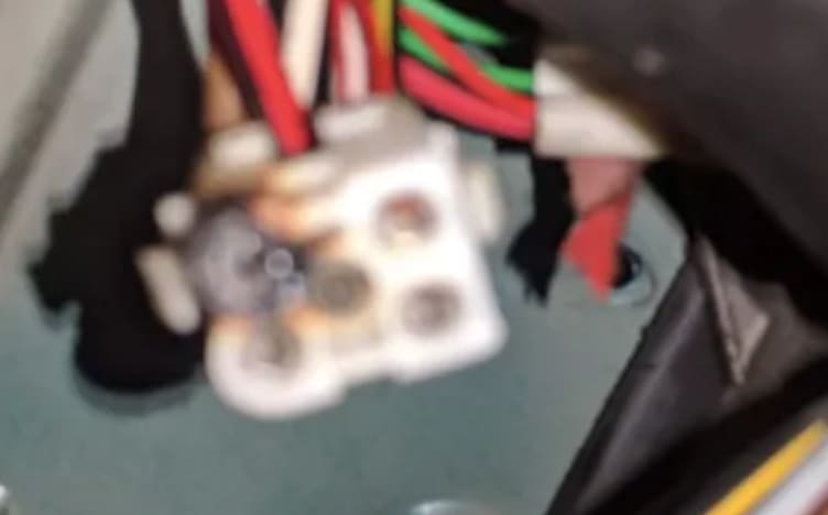

THe fan switch switches 12V between the different parts of the resistor.
Check your molex (White Nylon ok may be yellow now )
connector on the left side of the heater box there are 4 0r 5 wires depending on the speed as in 3 or 4 speed. Take it apart and look to verify that the ground wire isn't toasted. That ground wire allows all speeds to work, or not. I have had 3 Cabriolets and all of them had a toasted Ground wire. I spliced around it with a insulated Crimp connection straight to a new poin on the inner firewall.
Mmm, seems that the motor is seized, from the noise it is making. I'll strip it down tomorrow
Yep, stripped the motor and gearbox down, out some fresh grease in and oiled the motor bearings, screwed the switch contact plate back with stainless self tappers. All works fine
