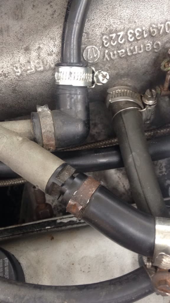

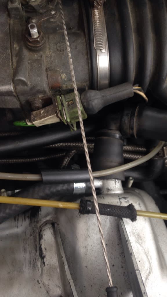

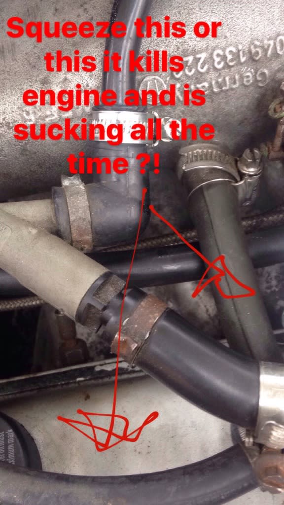

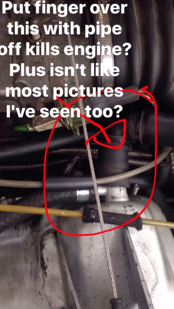

Pictures included- please post pictures of your oil breather pipes as mine are wrong ? I can't have my car running right till I get them right
Please post pictures of you mk1 golf gti 8v pipes so I can copy? And or part numbers etc where I can buy new bits from
If you remove a hose and plug in one side only, then that is a Vacuum or air leak on the other, and these little critters do not like vacuum leaks.
She had hose layouts for different model years.
I know that on my 90, there is a PCV valve of sorts off the valve cover that plugs into the hoses.
I do also know that there is a "Special" connector that has a restrictor on it on the pre-90's that isn't on the cars I drive. I have heard of cars running LUMPY if the connector with the restrictor is replaced and the replacement doesn't have the restrictor.
