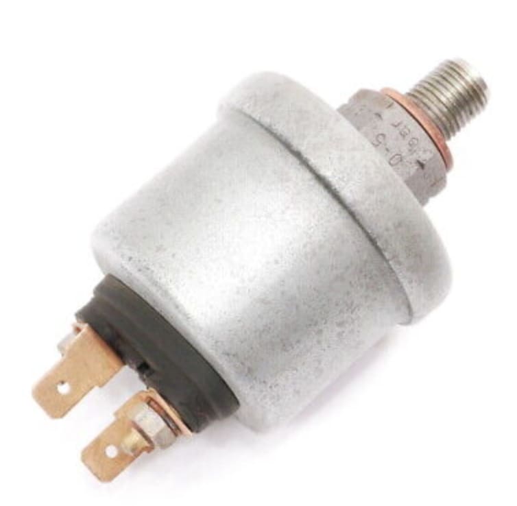

for info i used:
https://www.heritagepartscentre.com/uk/028919081d-oil-pressure-switch-0-15-0-35-bar.html
on the side of the head
and: https://www.heritagepartscentre.com/uk/056919081e-oil-pressure-switch-white-1-pin-1-8-bar.html
on the filter housing.

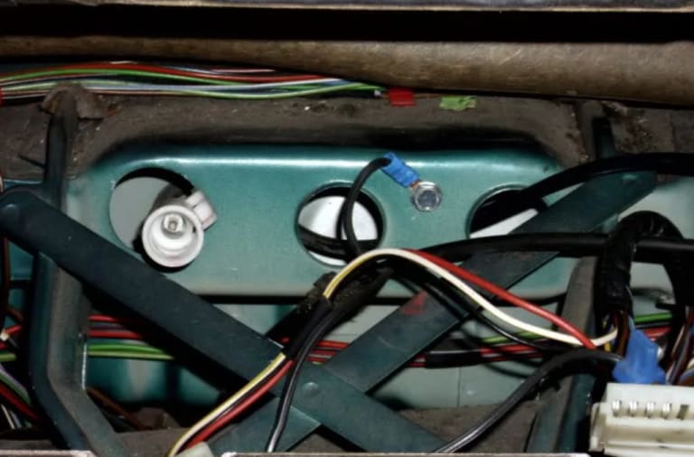

If you have the center console gauges that are oil pressure bar, oil temprature and voltage, you should be using the 2 wire sender
I have seen the single sender on my diesel rabbit, that blinked the gauge at
low level oil, so topping it off may help.
Using a good quality filter can stop that as in Mann, Mahl, STP, Wix, Purelator gold, Mobil1, Genuine VW,  are known by me to not have the Blinky light from hades.
If you have the center gauges then the proper placement of the wires are essential as reversing then caused the lights to go sideways a bit.

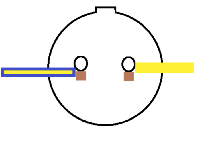

my 90's cabbies were:
Don't have the early 79-84 Cabriolet / convertible wiring diagrams handy.

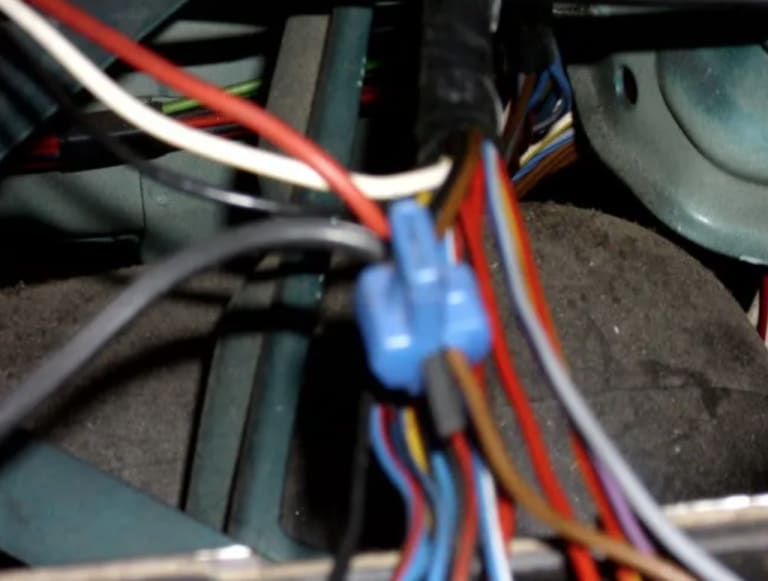

If you don't have the center gauges I would look into the wiring and grounds on your engine, and clocks.
If your Battery to Frame to engine/tranny cable is still oem or unshielded but a bad geren/brown color I would replace it out of hand and err on the side of caution.  I would also suggest adding a new ground wire to the main clister by splicing a wire in to the brown lead straight to the inner firewall on the connector side of the plug.
Only place I ever use a scotch-lok wire splice.
