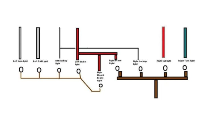

firsty thing.  Make a new ground with a large ring connector that will fit one of your rear bumper bolts in the boot.
Attach that to the bumper bolt then run it up to the connection in the middle of the lamp set, you are giving all the lights on your right a new better ground.
See if your lights work yes yeah, bad ground.  No, then use a DVOM.
Tur your lights on and measure the connector for 12v at the center of the lamp holder no.  Then a broken wire some where between the head light switch and the bulb.
Here are how the 90's are wired.
bumper bolt that I add separate grounds to each lamp holder.
lamp holder
