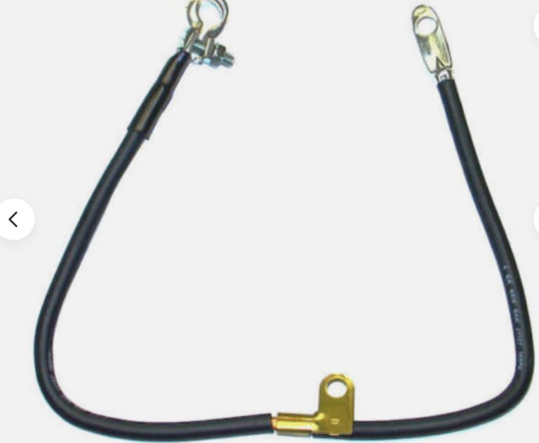

Connect the Black wire from the Negative Battery post to the Strut Tower nut.
Connect the Red wire from the Battery negative cable to the engine/transmission.
Works better replace your battery cables.

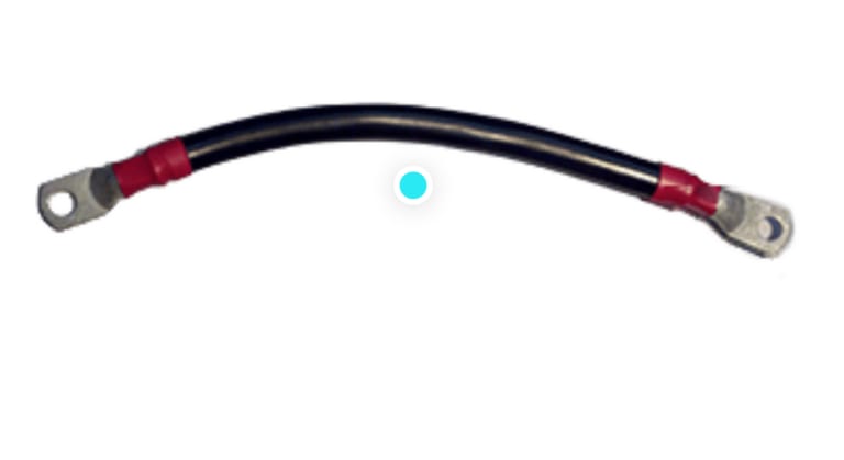

Battery-to-frame, and Frame-to-engine.y
You can use 2 off the shelf cables, with either a new single cable or using the 2 off the shelf cable way Spray the Frame connection with Battery protective coating.
One piece cable.
2 off the shelf cables the take off allows you to splice the separate cables that are attached to the btter terminal bolt with ring connectors to the take off cleaning the battery up a wee bit.
