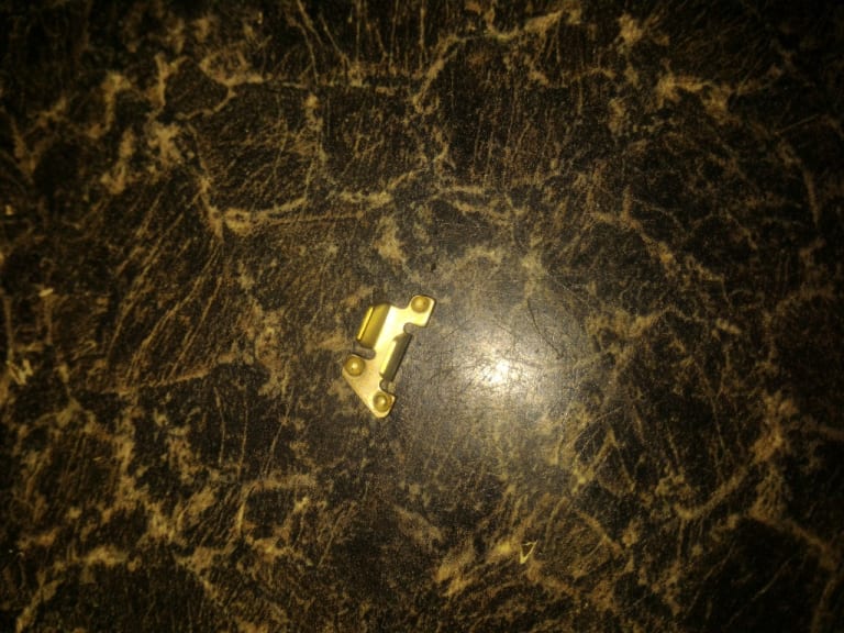

Don't have a clue why these do not work. I checked the fuses etc and all fine. Noticed that there is no supply to teh rear fog bulb. Also checked the fuse for the fog lights and noticed there is no supply there either. Appreciate any assistance on this matter.

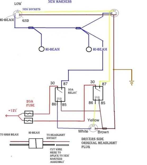

How I relayed mine, 2 and 3 relay configuration, the 3 relays allow your hi(fog) to shine with the low beam hi, and the low beam low.

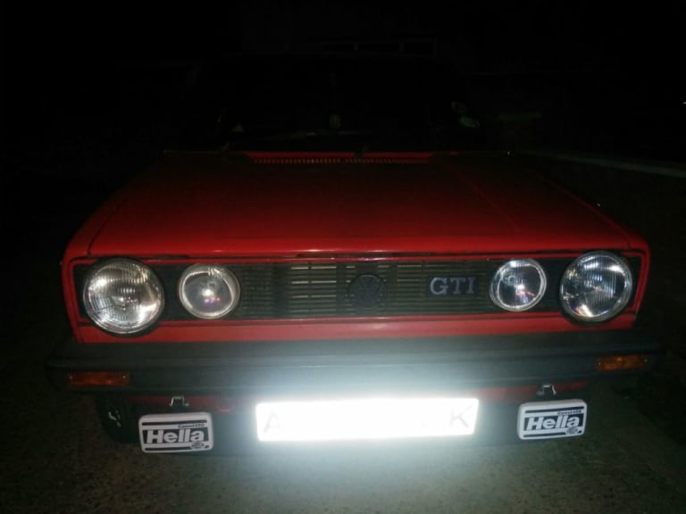

So the existing front twin lights, wired them up to full beam. Will look at original fogs later on or may buy aftermarket Hellas to fit below bumper.

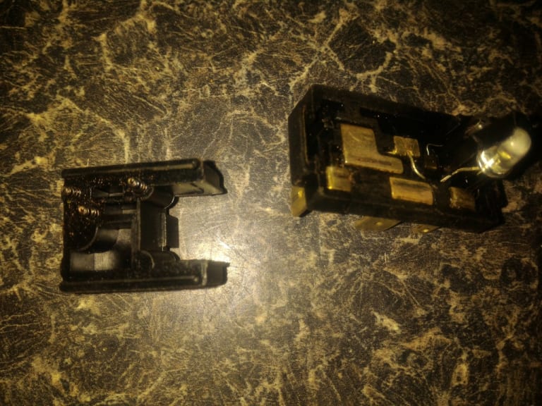

Ref the rear fogs, the culprit was the fog light switch. Disassembled it and found a thin plate was missing which slides across the contacts. Managed to find a plate, I had a spare headlight switch, the plate was compatible with the fog light switch. Now rear fogs work :)

So I couldn't source original fogs, absolute pain to find. I wired up the centre driving lamps which work ok with full beam.

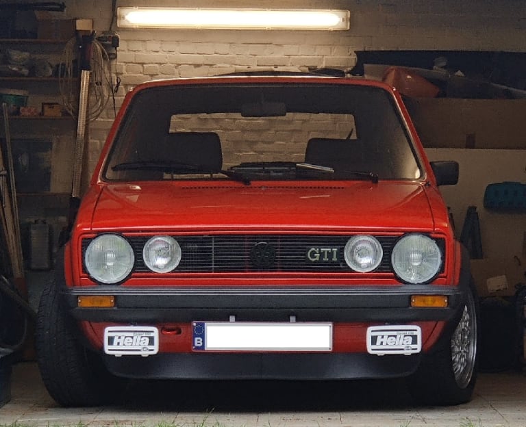

So I went for the next best affordable thing and bought some Hella Comet fog lamps to put under the bumper as shown in pic below.
So the kit comes with wiring and relay, but deciding whether to wire to the existing double pole fog light switch fitted to the instrument panel or should I just stick the to flick switch which came with the hella kit.
I don't really want to drill a hole for a switch.
If I was to wire to the existing double pole switch, how would I do this? Any tips are much appreciated. Note: the Hella fogs come with its own relay.

By the way, the picture above could be mine … It looks EXACTLY the same :$ Image_292.png

I believe you asked Mars Red LA2A?
Mars Red it is !
Hi mate, that's nice….yes very similar look.
I like the way you closed the gap between the bumper and fogs….I need to do the same to hide the ugly bracket.

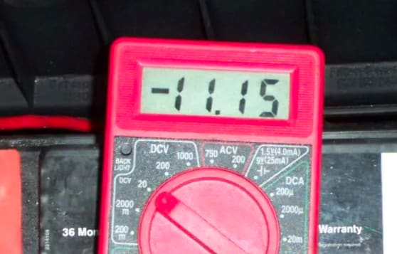

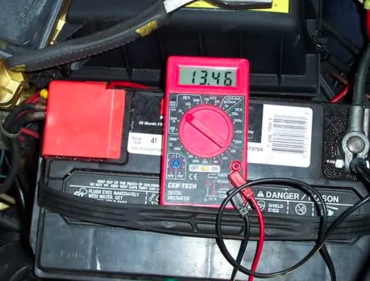

when I installed the relay kits (home-made) I went form 11.V on the lights to 13.4, they are brighter…
Added a 3rd relay and the high, and low filaments all come on together…
2 relay schematic

3 relays

Hi There,
Yes, I made my own brackets and connected them directly to the bumper supports. Didn't want to drill holes in my original bumpers  ;)

Wow, guess that will make quit the difference indeed, all filaments and +2volt bump! Who needs LED headlights anyway  :cool:
Thanks for sharing the schema! :thumbs:
