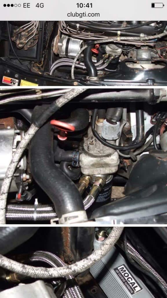

From the Sound of it you did install it correctly. But then was it the 30mm or 36mm gears?
I have a How I installed an external oil cooler in the link at my signature line, I used Scavenged Parts from a Wrecking yard I show pictures of how I did it and what the parts for it came from.
To install it you will remove your Water Cooled one, which is more of a Oil Stabilizer, than a true cooler.
You will rid yourself of the "T" hose on the Cooler and go with the 90 cabriolets water pump to Heater hard line.
You will need to remove and Plug your water outlet flange on the head or replace it with one from a Diesel or non-water cooled oil cooler that doesn't have the extra port for the cooler.
Here is a water oil cooler flange vs non-oil cooler flange.
I talk about it because of the Plastic flanges I had on my 92, and 93 Digifants that I had to replace at least once a year, so I finally figured out how to replace most of my plastic parts with Metal ones.

For oil pressures there is a good write up in the Bentley as to what "Normal" pressures are and they are measured with a Mechanical Gauge.

So I've done some digging around and this is what I want to do to my oil cooler set up, can you give me pointers please ?!
I'll post pictures below of what I'm after doing
My confusion is how oil is fed to the cooler I'm wanting to fit? Is it fed thru the pipe that goes to the oil filter or something? A diagram of the way oil flows would be cool ! I know I'm annoying but I just love tinkering haha
Why do you want to change to an air feed oil cooler?
The water type cooler is a better system as it heats the oil up when the engine is cold and cools it when it's hot.
The air feed oil cooler will not work when the car is not moving or moving slowly.
VW are still using the water feed coolers in there newer cars.
It seems a lot of work/effort and expense for no real gain.
As long as you use the correct antifreeze mix and regular changes to the coolant you should not have much trouble with the water cooler.
As the saying goes…….. if it ain't broke don't fix it
This is just my thoughts..

I wanted to run both, I'll post a pic.. green highlighted water cooler and red highlighting the sandwich leading to the air cooler.. I don't really trust the dinky lil water oil cooler on its own, and think it can run both from looking at the pic.. I was gonna mount it with the rad so the if I'm stopped the oil will cool from the fan, I want it for drives to seaside in summer with my friends etc I just wonder how that guy did it and what he used
I do get if it ain't broke don't fix it though ! And respect fully what you mean.
Thank you for reply
140 degrees C is getting towards to danger point of oil.
115 degrees C is the top my oil got in the Golf on a couple of track days, quick driving on a motorway.
120 degrees C in my Mk1 Scirocco with NO oil cooler fitted and driving at 4500rpm on a motorway for about 2 hours on a hot sunny day.
I think 2 coolers is a bit over kill for a road car, fine for a track day car.
