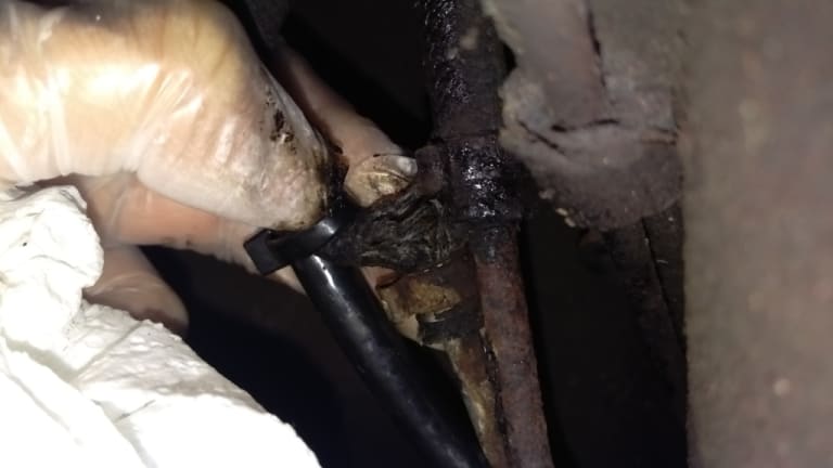

I have a mk1 golf and i filled up petrol today ran the car to get it warm didnt drive it around.. as i was just cleaning up the car i noticed fuel leaking directly underneath the car at the rear , it was leaking alot… But noticed it was some sort of mesh pipe which holds a metal pipe into it and some sort of clip to hold the pipe into the mesh.
No other place the fuel is leaking just that one place.
I wanted the name of the pipe and possible causes? As this unuseal never happend to me before.

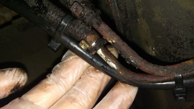

I will try get a picture of it. Okay so got the pictures I found that the mesh has a whole in it so fuels coming out from that. How would i fix that? Rubber pipe?
Last edit: by harshalkumar240
looks like the rubber pipes need replacing, however take care as the steel fuel lines are rusty and fragile.
Regards Volkswarren
