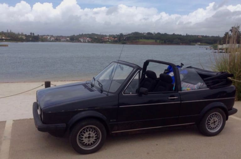

It starts, now it doesn't, it starts, next it does not....
1982, 1600cc injection engine, all re-done.
Everything is new except for the engine block !
Injection was refurbished in Germany Bosch Classics.
Works well, runs well, BUT, once I stop, in a few minutes it will start OR NOT !!!
It's so annoying….
Been to a Bosch Car Service where they had an apprentice…. and this boy in a few minutes cut and broke a lot of stuff before I manage to have him put aside from my car.
After that, engine starts and stalls….. been to other 3 places and no one knows what to do…
Does this happen to anyone ? Any hints?
