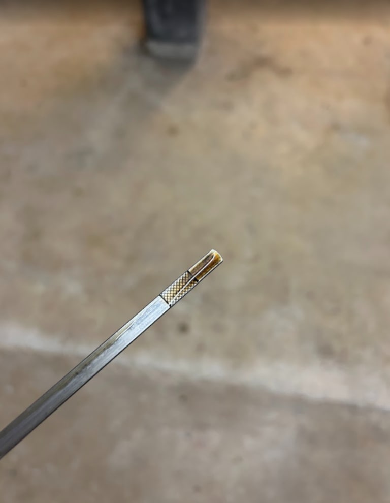

Car don't start well when cold, idle rough (like on 3 cylinders)  for 10/15 seconds then adjust itself.
After a ride sometimes starts with a 1/4 of turn, sometimes takes forever…
When cold (never tested after warm) spits out black gunk from exhaust and smells terrible (see pictures)
Sometimes lose power when under load (very rare)
Idle, after a while starts to going down, almost like it wants to shut the engine off, then comes up again, this happens when warm too
Rattling noise under the car (could be the heat shield?)
Things checked so far:
Timing is perfect, igniton timing too (adjusted with a strobe at 2250, CTS sensor unplugged. 3 times revved past 3000 and plugged back.
No oil consumption, no strange oil colour
No russian salad in the valve cover, nor in the cooling fluid tank.

Screenshot 2025-06-08 150942.png Screenshot 2025-06-08 151002.png Screenshot 2025-06-08 151127.png
