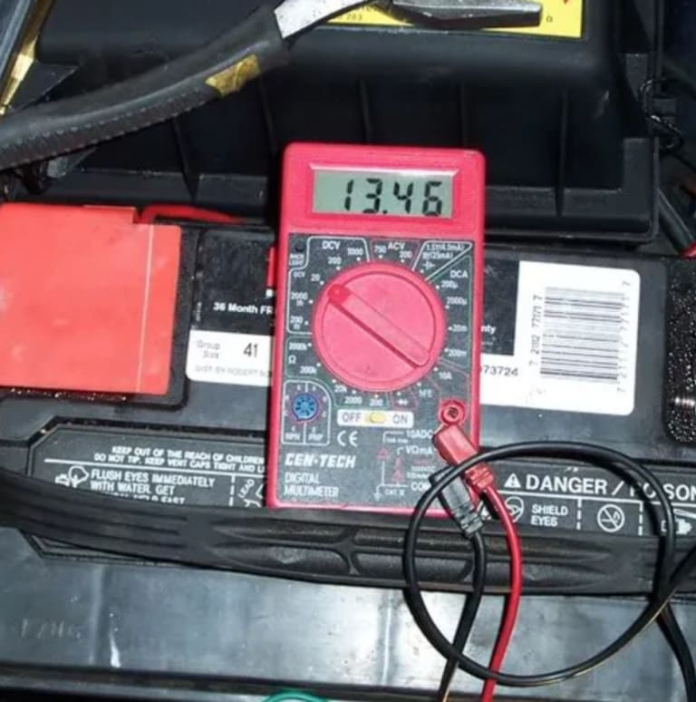

If there is a .5Vdc drop in voltage between the frame and the battery you have a bad cable.
Briano's Quick Grounds test. | Volkswagen Owners Club Forum

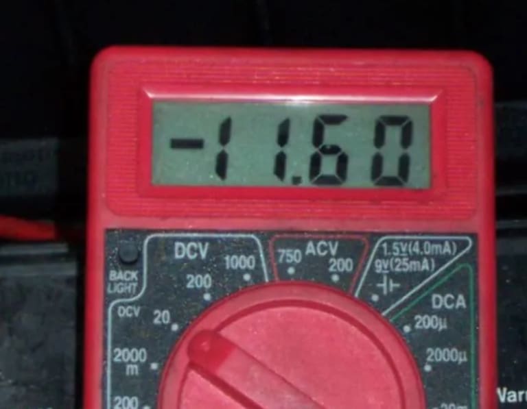

This re-routs the high current load off of your headlight switch and directly feeds the headlights straight off the battery.
Before voltage at the headlights.
After relaying.

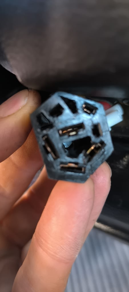

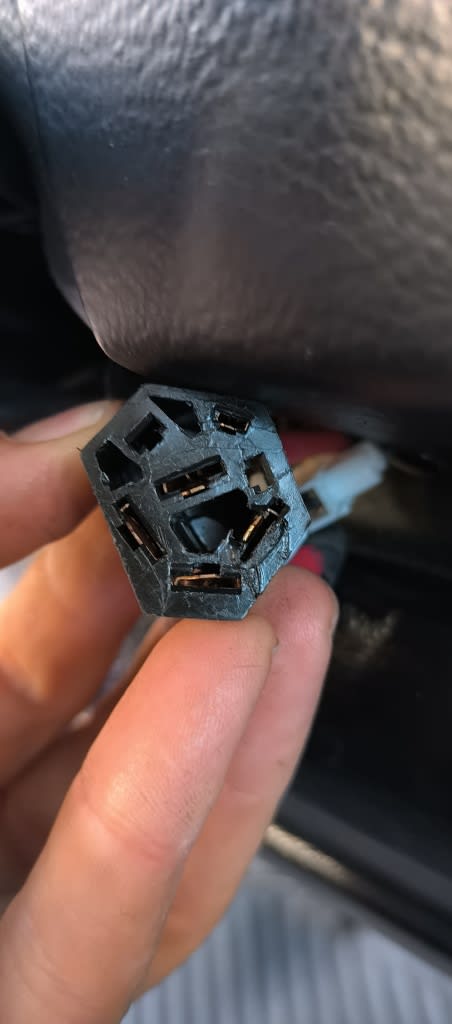

Anyway going back to this problem I thought it was something to to do with the immobilizer added but when I turn the key and have it started and then gave the key a wiggle the lights work as the imo light goes out and the windscreen works normally. So I do you think it's the switch
I personally would solder and heat shrink that thing.
If you can depin yur old one, then the pins don't look that bad, and you may be able to re-use them.
