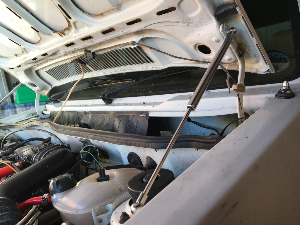

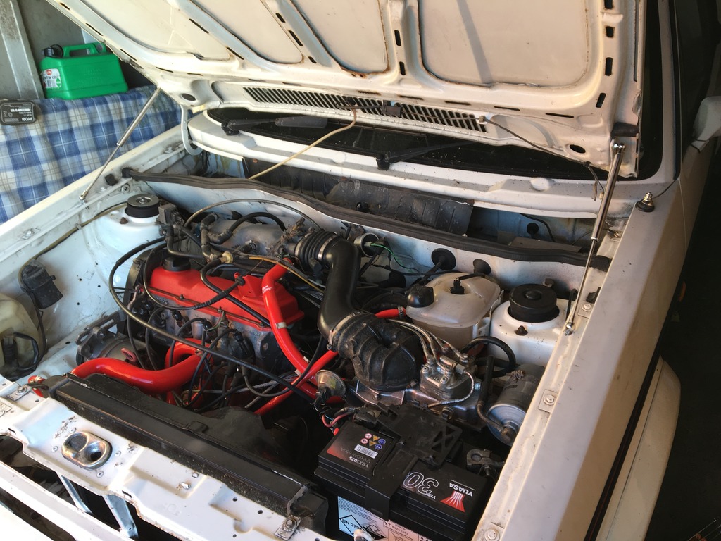

I had this exact problem on one page there should be a diagram with measurements I just went off that roughly mine need tidying up a bit tho
I ended up sending mine back. I was told there would be no drilling required before I got mine.
Arrived complete with German instructions and offering them up it was clear there was no way they would fit without drilling. Messaged the seller several times who told me they were the same as the astray and I needed to send pictures of under the bonnet. Several messages more to them and they agreed I would need to drill the body. I was offered £5 refund for the hassle.
Not happy with this i ended up returning them back to Germany costing me £11.1If the struts were sold 2" longer they would line up nicely with a wing bolt hole but they weren't keen on checking the lengths of the other kits they supplied. Good luck anyway.. 20170329_162249.jpg 20170329_161526.jpg 20170329_161348.jpg 20170328_144139.jpg 20170329_161425.jpg

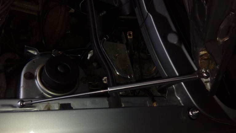

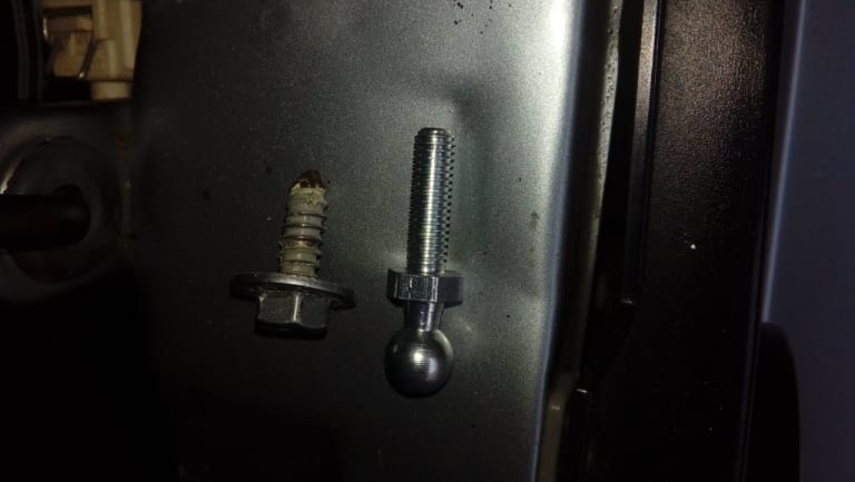

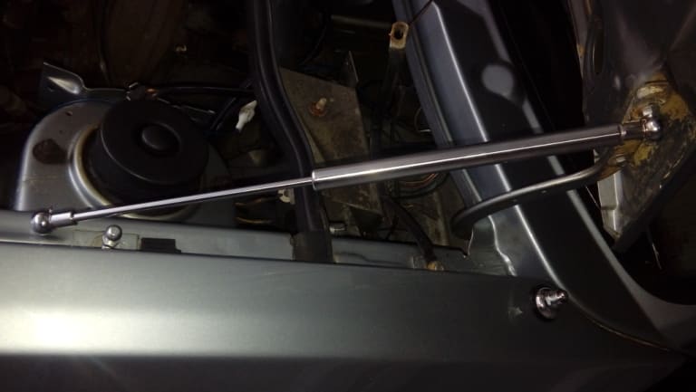

Please don't drill your wings and inner wings!
All the ones supplied for Mk1's are too long to line up with a wing bolt hole.
There is an easy solution though!
Unscrew the fitting off the end of the pistons rod (I had to heat mine up slightly to loosen the glue). Cut some extra thread onto the shaft and shorten it so that it aligns with a wing bolt hole. Refit and enjoy!
