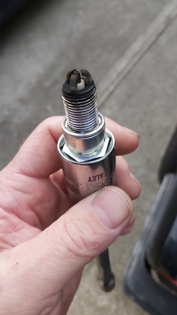

Interestingly it ran fine home today, switched car off, straight back on again and it started misfiring, so I turned it off and back on again and it ran fine again.
I've swapped plugs around, ht leads (miss is always on cylinder 1) but makes no odds so not those but given starting and stopping the car made it come and go I'm thinking a wiring/earthing issue?
The car has had I the last year injectors and lines, and at Easter a new ignition coil, plugs, leads,cap and rotor arm. Anyone got any ideas as to the best place to start looking wiring wise? Or am I likely barking up the wrong tree?

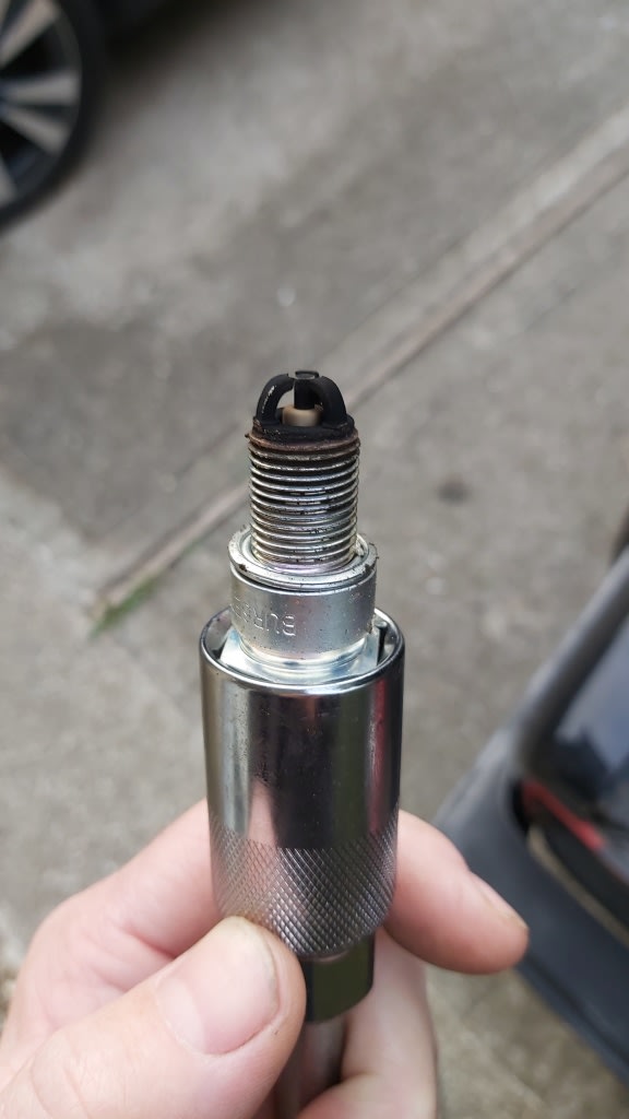

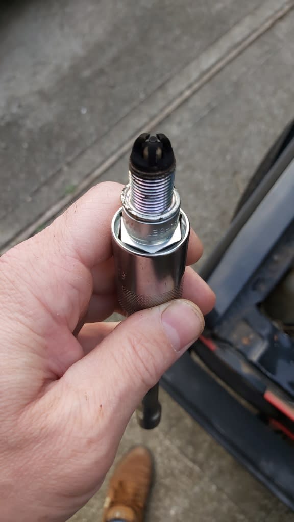

One thing I did notice is that the plug in cylinder 1 was slightly carbon fouled perhaps and that cylinder 2 was a glazed yellow colour, which as I understand could be due to ignition too far advanced or lean mixture. Hopefully I'll get some birthday money next week and treat myself to a timing light and maybe a compression tester, though given the misfire appeared then disappeared again through starting and stopping the engine (when warm) I think that's not likely to be the problem, I think it's probably electrical but I don't know lol it does stink a bit of fuel when doing it though but I guess that's inevitable

Reading more about the yellow colour of the other plugs which suggest the plugs getting hot quickly during hard acceleration (which I don't do huge amounts of)
Clean them up give it a good itallian tune-up run
Read you can use a colder rated plug to overcome this though plug no2 doesn't look nearly as bad as those did when I changed them last year, haven't looked at no3 and 4.
Will give it a bit though, then maybe look into different plugs see if it is advisable or not really on a dx
