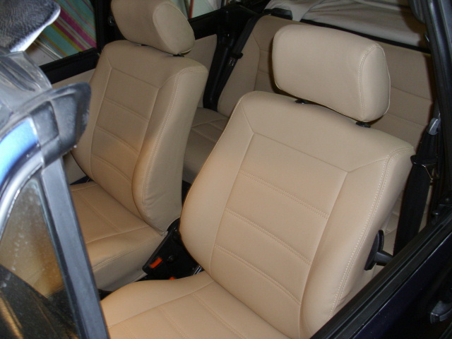

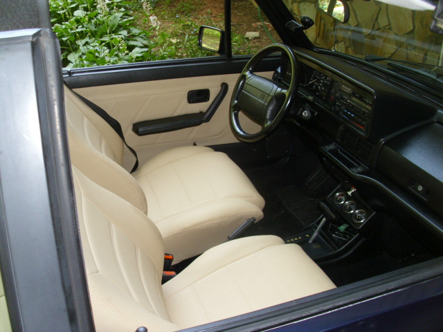

I changed from All White to Tan.
partial shot
front seats will fit if you cut off and re-weld one of the rear legs further inwards

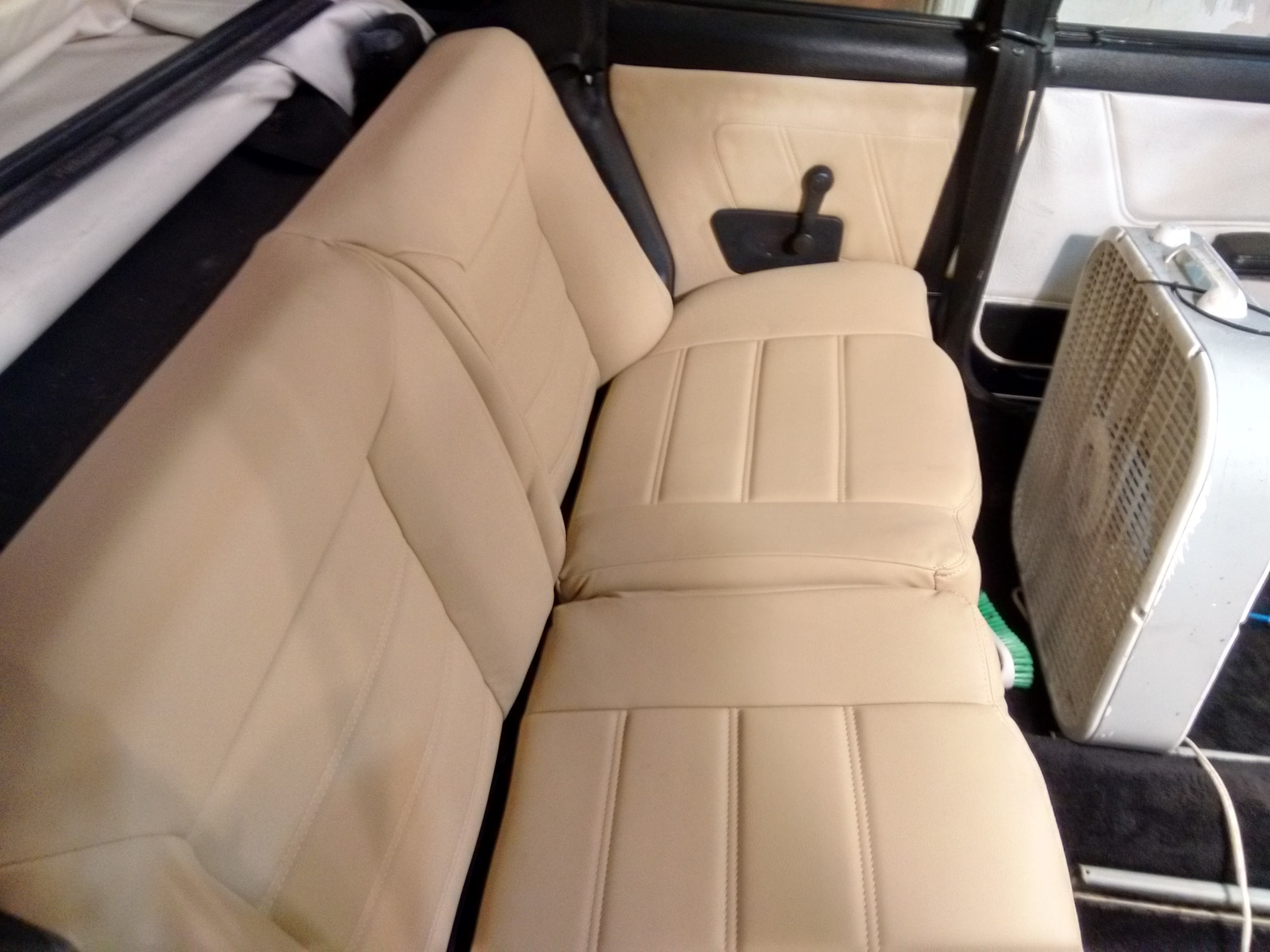

the mk3 rear seat is far too wide so would mean retrim to get the rears to match
