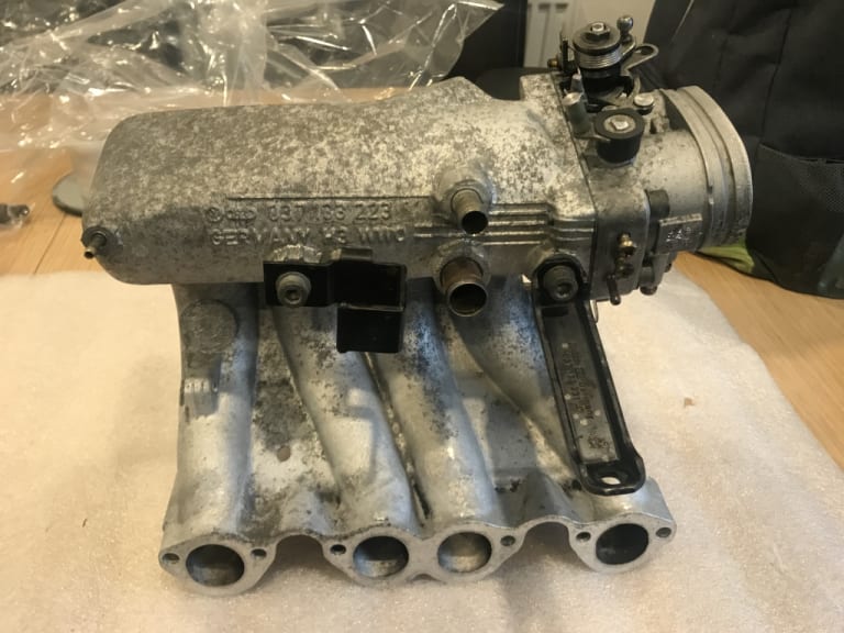

I have a Golf cabriolet 1991, and i am trying to replace the inlet manifold gasket as shown in the picture.
Can anyone tell me where i can purchase a new one from. also any ideas on whats the best way to clean out the manifold.

Well if you have the manifold off you can use a Carb cleaner spray, I would be sure to take care around the throttlebody.

Plug up the vent hole and a good soak in degreaser over night, blast of water down the vent hole washes most of the gunk out then leave to dry before fitting.
Yes iv give it a good soak with de-greaser power washed it all off inside and out. Iv blown down each air hole so should be good to go back , once my new exhaust manifold turns up.
It will get all the pitted black off the manifold and make it look like new.
