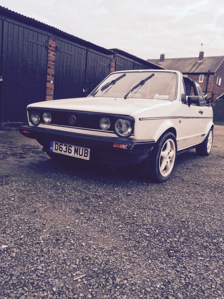

Just want a definitive answer if I have hydraulic t
Any tips or guides on this job would be appreciated!Â
I'll attempt lapping them with a very fine paste too advice on that would help massively. Pictures of my car and head
