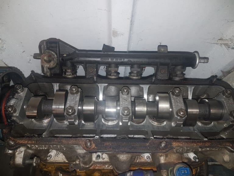

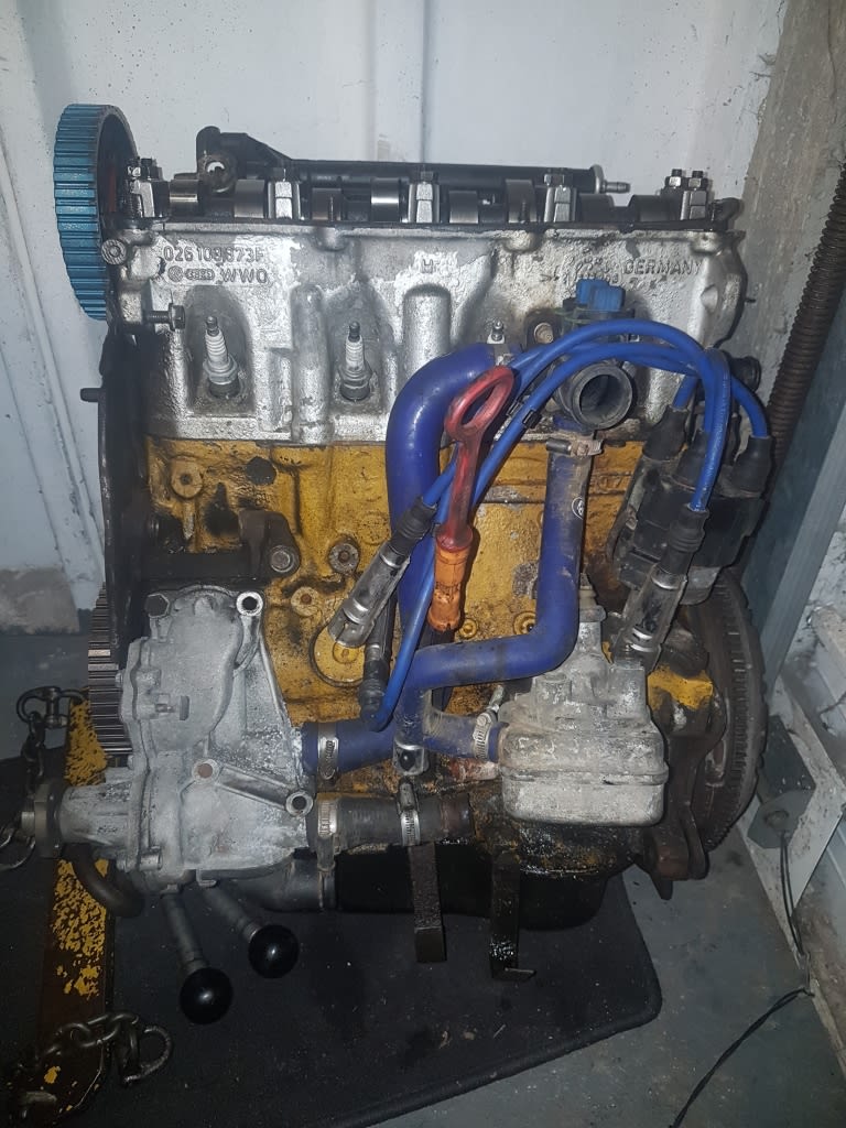

I'm after some help i have just purchased my first golf mk1 it was a non runner as the bottom end was seized, the person i purchased off said it had various parts on but i have no receipts for this he said it had a 2.0 audi e bottom end mk2 16v gearbox/and a tsr pack c head (i do have a receipt of this), would any of you know what parts this has got? I've removed the engine now and want to get it back on the road asap but not sure what block to buy or even if the head is any good and what engine is best to replace it with your help will be greatly appreciated, thank you. 20170317_180659.jpg

Well can see its a 2 ltr , written on the block, and a good conversion in a mk 1.

By the sounds of it:
Your gear box is ok
Your head is ok
Block is shot.
If you can find the code from the block then you can research what cars that block came in, find one in a scrappy (or going cheap on ebay) and swap the block over.
Or just pull the lot out and replace it all with another engine.

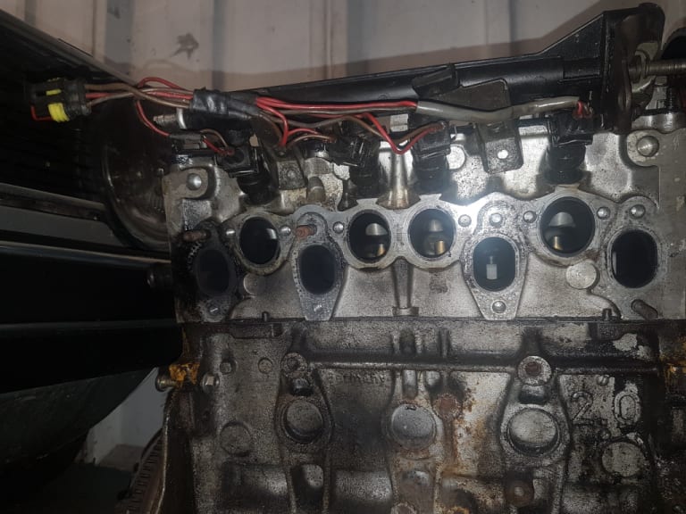

You seem to have an early head as you have 5 cam shaft caps so it's got shims and buckets, heads with hydraulic tappet don't have No. 4 cap fitted. You also have digifant fuel injection system (later cars used this system) early cars have k-jet injection system.

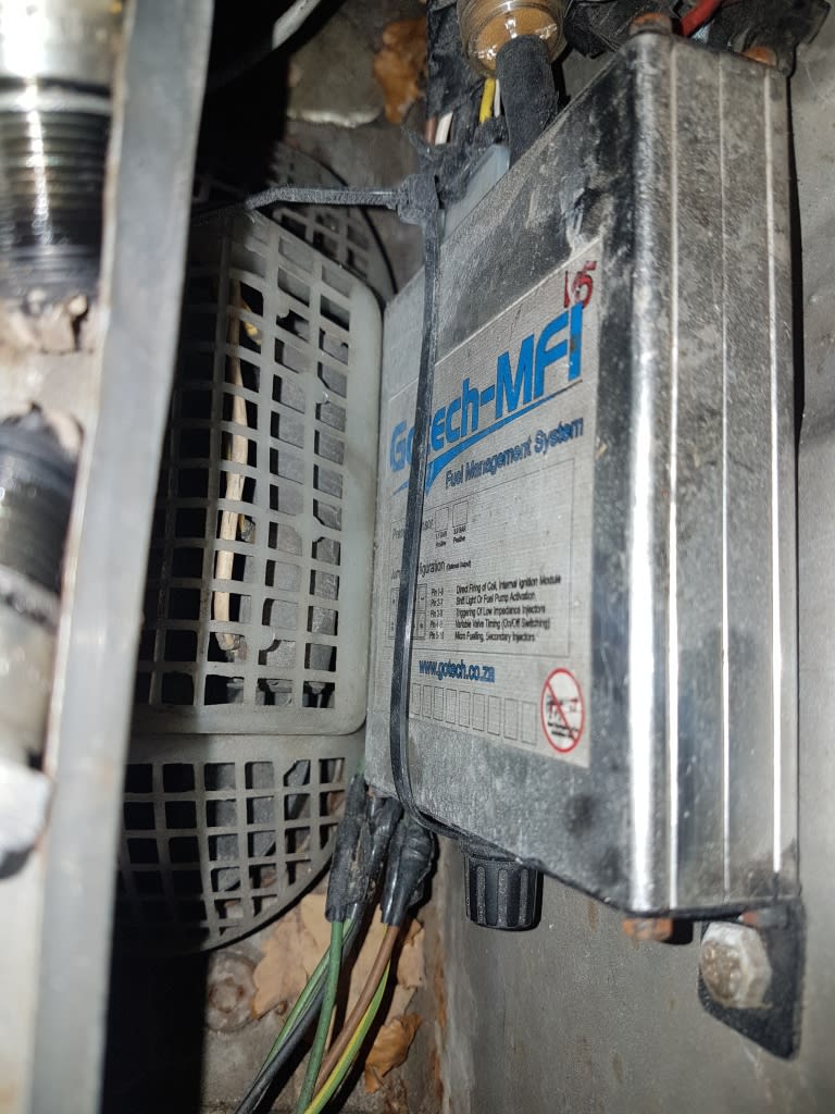

injectors and inlet are digifant but you have an aftermarket ecu. the block looks like a mk3 golf or audi so should be easy to find a replacement, just swap everything over. looks like there is blanking plates fitted to the block breather

also just found these numbers on the block do they mean anything? i think it reads 048103021b

If you're keeping it 8V (and I hope you do) assuming the head was produced while Tim Styles was still the owner of TRS Performance then you have a real diamond. Drop it onto almost any 1.8 to 2.1Litre bottom end, the more work the bottom end has the better the head will lend it's self. The bubble block is best by far from early 2.0l Audi but they're rare as rocking horse poo now.

i just need to make sure the head is ok. if not would a mk 2 1.8 gti engine fit?
