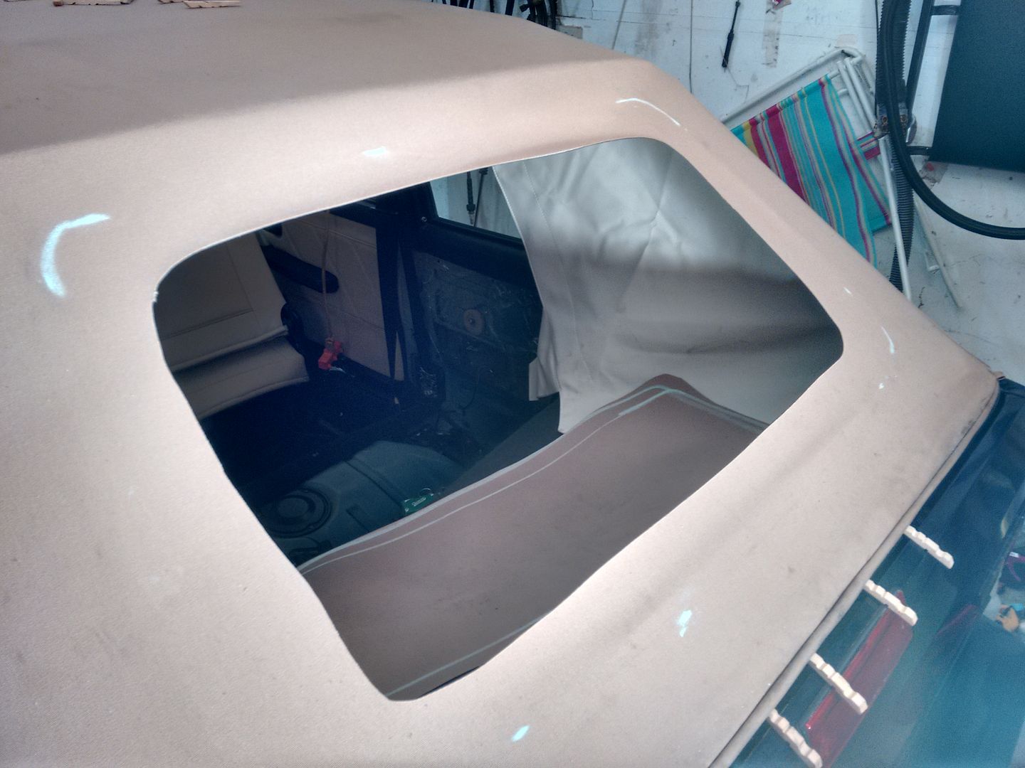

Did you cut out the rear window opening?
This is what you see on a mohair roof, when you didn't cut the rear window opening
You mark where the rear window frame is meeting the hood with chalk, then go inside about 4-5 inches.

Cutting out the hole for the rear window releases the tension on the top, Vinyl hoods can be installed either way, cut out or no cut out as vinyl will stretch and forgive, Canvas or mohair is a wee bit different as you have to cut out the rear window so your cable will stay seated correctly, and that your top won't close fully.

And yes, after i done all the work with the headliner and inter level i tried putting the top skin on, to see whats the best way of doing it, just as a try out without glueing, cutting etc. so incase its to tight i would not waste any time on it, as per my first post i kept the roof skin in a very warm (over 40c) room, for some years, hence my worry, mohair as a material tend to shrink.
When i compared new and old top skins i noticed that the new one is significantly smaller, hence i laid it on top while i was still working on the other levels, for pic purposes so i could explain better where the issue is.

You mean the hood pull in straps and the interliner straps are riveted to the frame.
Personally I would not follow that video.
The finish on that hood is not great.
The lower beaded edge is all wonky all the way around.
Rear cable is showing.
Plus where the trims go for the cover are awful.
They aren’t in line.
Plus the front side flaps are not pulled round far enough and corners aren’t seated correctly.
