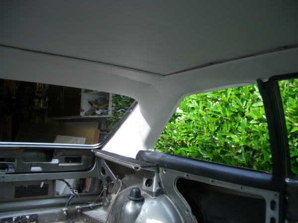

I paid a trimmers to make and fit one in my Mk1 Scirocco, he also re trimmed and fitted my Webasto roof, re fitted the A and B piller trims, I even had a choice of colours and finish. It was about £200 all in, took him a weekend.
I took the car in with no windows and the Webasto in bits and in  the boot.
Old headliner was ripped and torn.
New headliner.
New roof.

Fun me mark that's some sunroof, out of a polo?
mark1gls
Hey Mark that roof looks perfect mate and for that price with what you presented him is insane!  :lol:  :thumbs:

I found a "1 man band" trimmers who works from his home so no overheads. He also re trims car seats, motor bike seats etc. He's been doing it for years and is not far from where I live in Somerset.
I could not work out how to remove the Webasto roof so I cut it off as I needed to remove the rust around the hole and check the wood put in the roof was ok.

I took my car to him with no windows and no interior, I had just had it resprayed so I had to get it to him on the back of a transporter so I guess that's why it's a better price, I then had to get the glass etc back in my self.

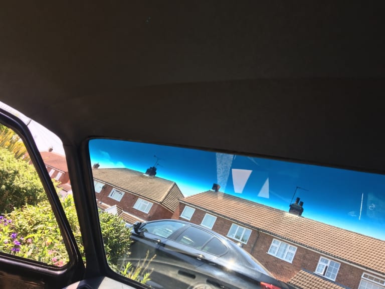

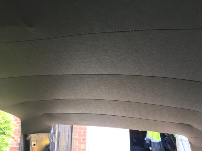

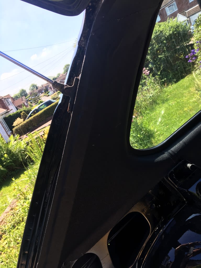

Well I done it and fealing pretty damn pleased with myself. Just have to polish all the glue off my paintwork now.   IMG_1176.JPG IMG_1181.JPG IMG_1185.JPG

Great work mate , that's a mighty sunroof, the second last pic the section of roof beside the boot strut is there foam underlay under the headliner?

Aftermarket sunroof . Put the hole in for that last night so completely fitted now. Original insulation under the head liner. A B and C pillars straight to the bodywork. The kit comes with a slightly different B pillar arrangement that runs under the rear qtr glass to finish the inside a little better originally this was just paint. Look good I think though as my car is black.
