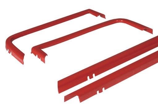

Red trim
Here is a rear badge that held on after collision. Yes Black RTV.
I think
That red beading can get hard/brittle over time and become lose and even fall off.
Not sure but you maybe able to get a new replacement one. So I'd try www.werk34.de as they do a lot of trim parts.
People do glue them back but it depends a lot on the condition of it as to how successful it is.
Some I've seen have just left it off and painted the red on by hand!
https://www.werk34.de/product_info.php/info/p10165_Trim-set-for-grille-4-piece--Golf-Mk1--Red.html
As long as the red trim still has the little lugs (see picture) that bend against the plastic part of the grille you should be fine. They usually get bent out of shape when being removed, shouldn't need more than your fingers to press them against the grille to hold tight.
If your trim is a bit 'wonky' you can get an Allen key (7mm I think..) lie it down in the reverse side of the trim and tap it gently to even out any bumps.
Paint it Mars Red 1.
Alternatively go ant buy some new, but not as satisfying.
