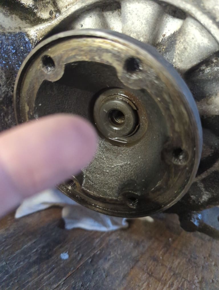

So I'm in the process of rebuilding my gearbox. And there appear to be a raft of "special" VW tools required so I'm also making those as I go. Gear selector is out, needed the big 27mm hex for that, now I'm about to remove my gearbox Drive Flanges however I have to compress them with some little tool which bolts down into the centre of the flange (gearbox side) so I believe it's an M10
bolt, but not sure of the thread down in there. So does anybody know for sure what it is so I can go out and buy the right bolt?
Also, they are 100mm flanges, not sure if that makes a difference or not.

its not that you need it to get the circlip/flange off but to get them back on. Be aware there's a FO big spring that can fire the flange across the garage taking your head with it if not careful
Thanks for the heads up with that! Will take extra caution when I start to take them off. Still need to figure the bolt out though.
There info and sizes of the threaded bar you need to remove the circlip here.

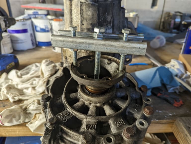

My homemade tool for removing the drive flange can be seen in this post - View topic: 83 GTi - now MOT'd! - The Mk1 Golf Owners Club

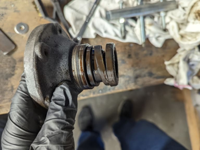

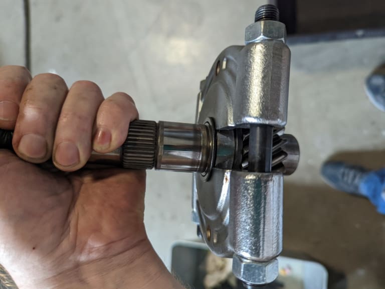

Ok so I made up this guy with some unistrut I had laying around. One M10 and two M8 with double nuts etc. Turned out pretty good and worked a treat. One flange off already.
I will be doing all seals and bearings at this stage and then anything else that isn't 100%. Will find out once I open this baby up.

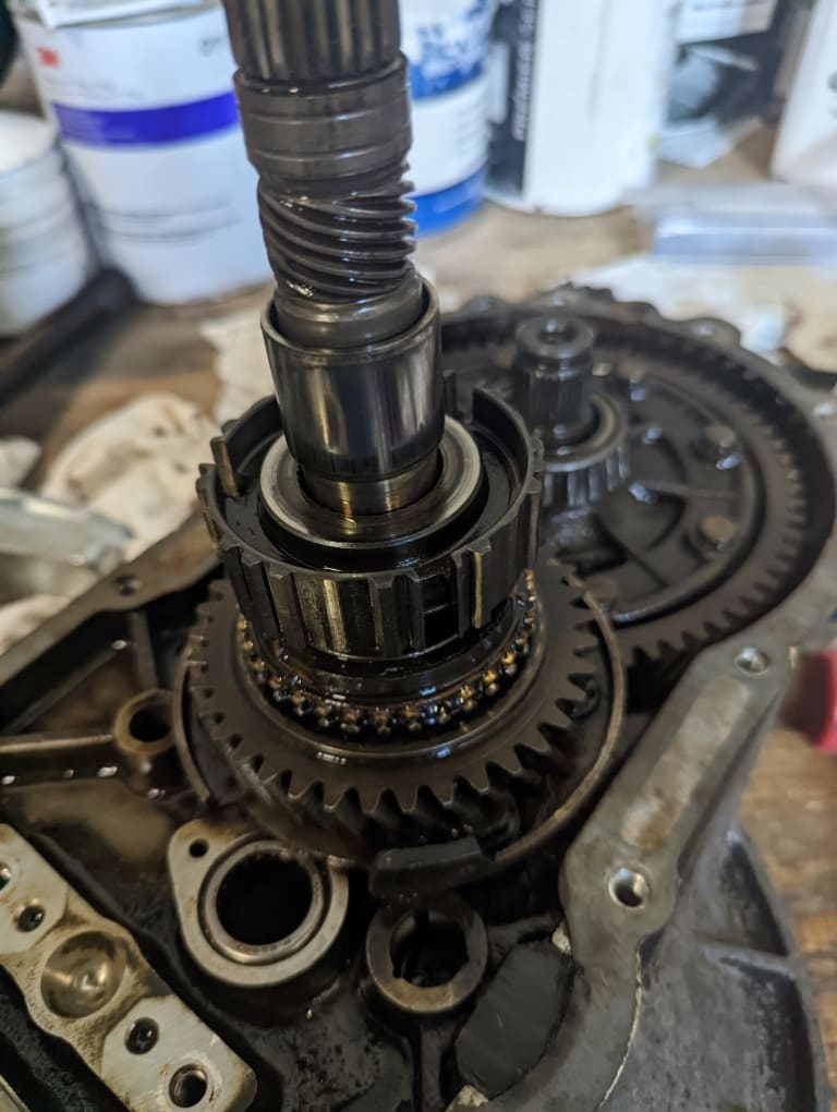

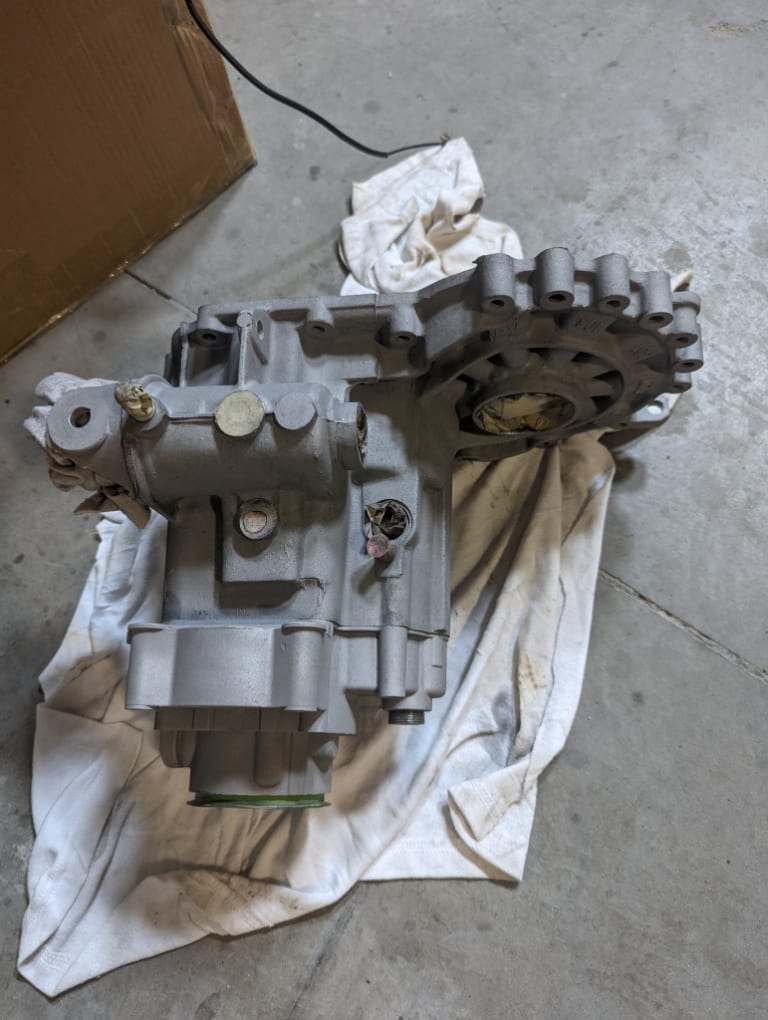

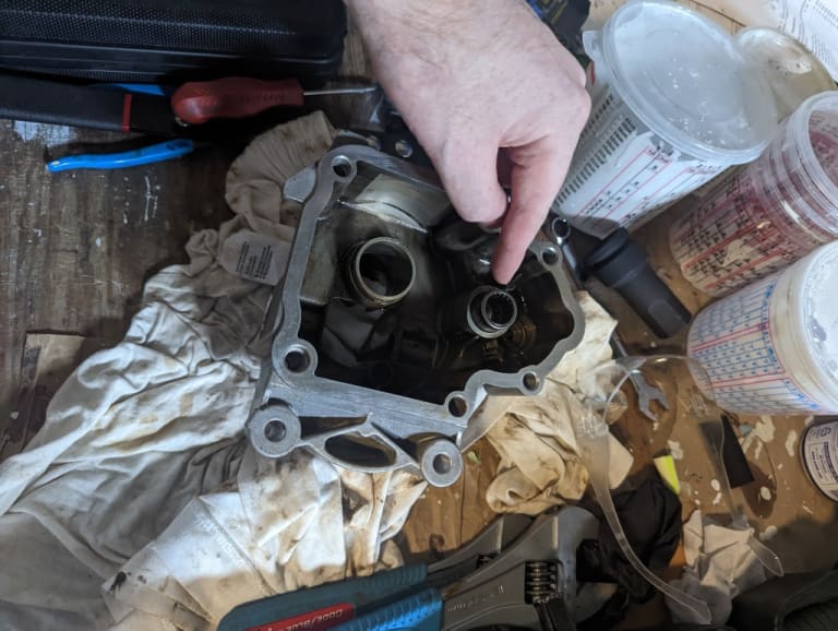

Ok so I got a little further into this. Drive Flanges removed, got  5th gear it's shift fork removed, unbolted the tension bracket for the deep groove ball bearing and removed the transmission housing. Been cleaning parts and stuff as I go. Anyway I was cleaning the 5th gear shift mechanism and syncro and then pop the mechanism fell apart. So does anybody know how to take it completely apart so I can clean and then how do you get these little widgets back in. Looks like there are two circle springs in there similar to the one that holds the steering rack end on. Just not sure how to remove these ones so I can split this down and clean it.
Paceman I Think I've fallen down the rabbit hole on this gearbox. Gonna be a complete clean and rebuild me thinks. OCD is kicking in and this box is mangey inside.

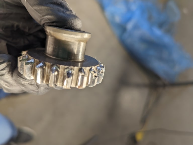

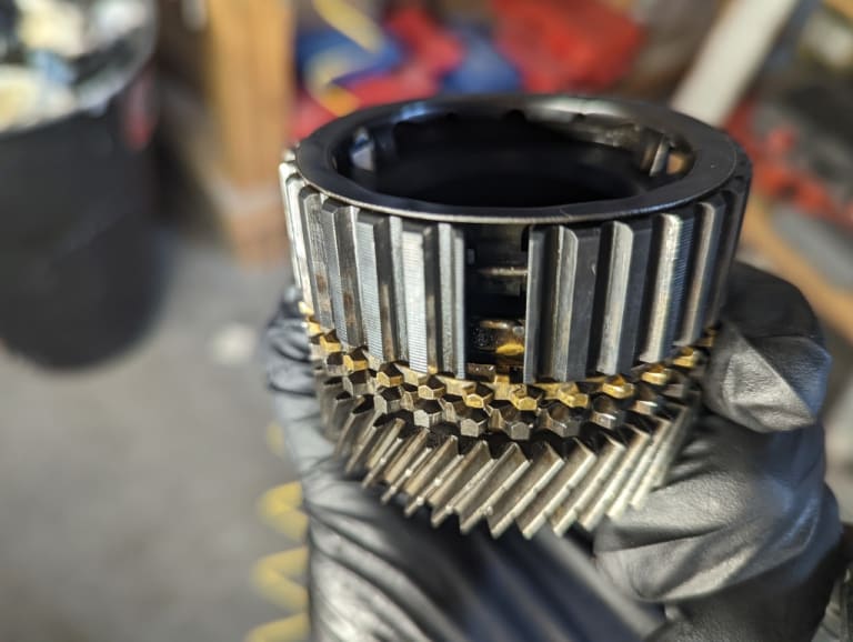

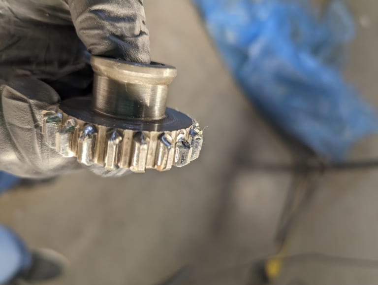

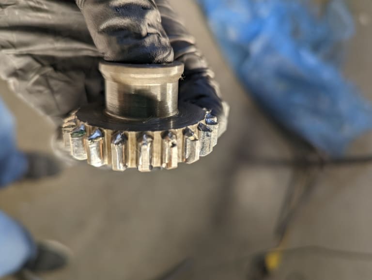

Ok further into this now and waiting for my extra long gear pullers to arrive before I can get 1st gear and the shaft out. Anyway been cleaning parts as I go along. So my question is how bad is a bad gear? This is the little gear that moves up and down on the shaft to engage reverse I think. Does it need replacing? Has three places where teeth are chewed Some pics attached. Also same question for the clutch lever seems to have a bit of wear on the shaft near where the spring would be. Any ideas if these are going to be a problem moving forward as is or if I should replace?

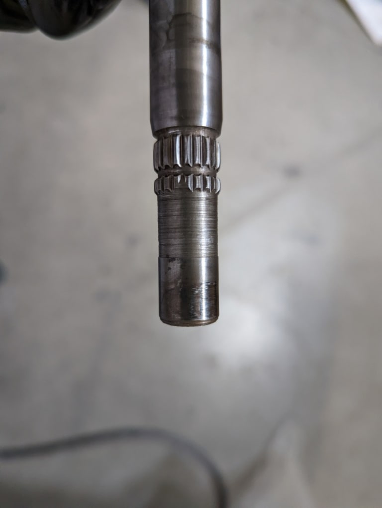

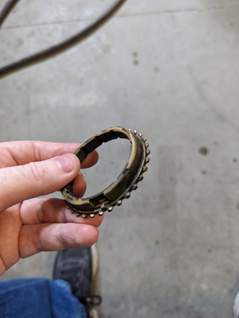

And same question for the synchro. Think it's second gear synchro. Cleaned it but it looks kind of burnt or had PXL_20220423_175504475.jpg some serious heat or something.
PXL_20220423_170550788.jpg PXL_20220423_170555292.jpg PXL_20220423_170604474.jpg PXL_20220423_170550788.jpg PXL_20220423_174717272.jpg PXL_20220423_175455688.jpg PXL_20220423_175439368.jpg PXL_20220423_175433185.jpg

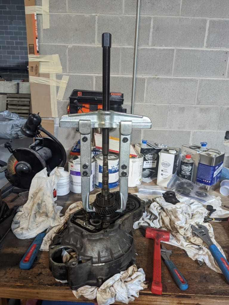

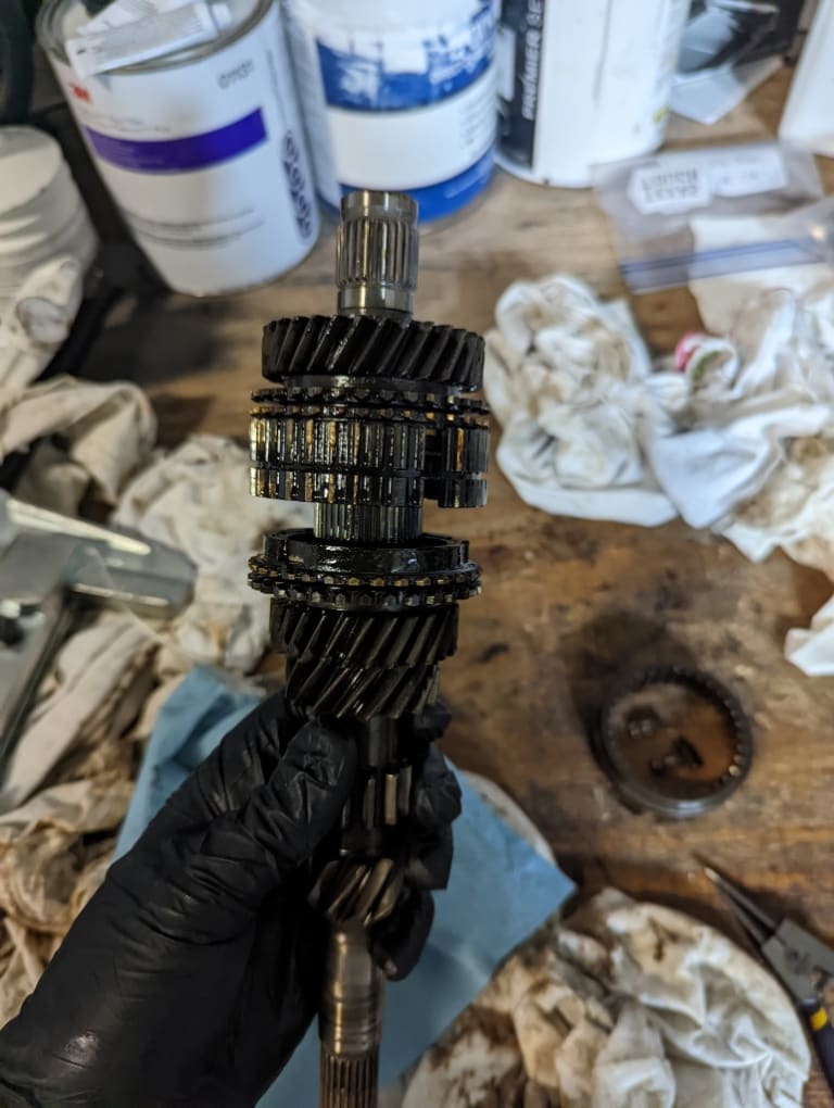

Paceman, i know you were interested in this so heres a quick update. Have both shafts removed from the gearbox now but had to purchase a special gear puller with extra long legs, not cheap! But needed it to get the 1st gear etc off the shaft so i could get access to the bolts that hold the plate on and the bearings in place. Have that removed now and now waiting for a special blind 2-leg bearing puller tool to get the inner race out. Also apparently there is also a VW1582 tool required to get the bearing off the shafts. Not done that yet but might try to avoid purchasing the tool and use the press like shown on brokevw etc. Not sure if my bearing tool is as flat as the one shown on brokevw.
ISSUE: Anyway the big issue i have just come across is that not all gearbox repair kits are created equal.  The kit i purchased (before i striped the gearbox) i found out, only came with just the big ticket items, drive seals, bearings and two of the internal shaft bearings (the ones that need the races) and few other seals. however its missing all the roller cages, needle bearings for the shafts and all the synchros. Anwyay the biggest problem is that there is a roller cup bearing F201764 which is apparently obsolete. So what is everybody using to replace this with? I have it removed from the gearbox so now i at least know what the part number is but now i need a new one to put back in……..AARRRGHHH!  O_o pictures of the bearing in question.

Heres a photo of the big gears pullers i had to purchase. I have several gearboxes to do so i assume i will need them again.

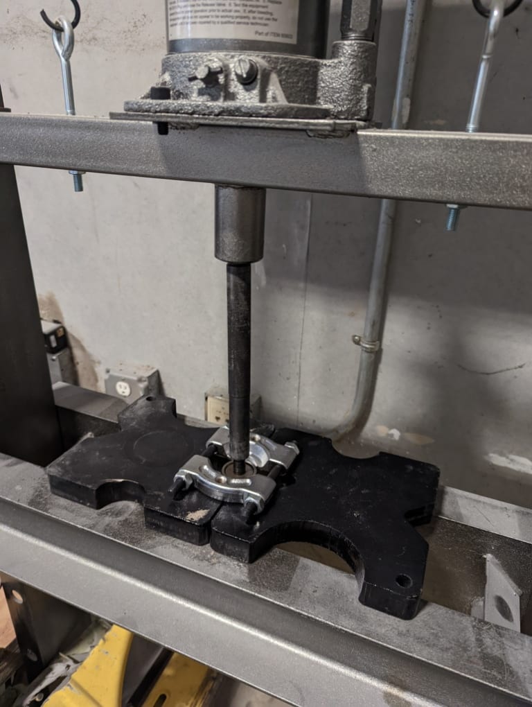

Paceman, another update for you. I got the output shaft out after I used those big gear pullers. Once the shaft was out I took the diff out and pulled the bearings off. First bearing on the side with the dome that houses the the gears was no problem for my tool. I used the flat face of the tool. The bearing on the other side was a pain. My tool didn't fit. The bearing was too close to the face of the diff gear and couldn't get a good bite on it. So parked that, and hummed and hawed for a while then decided to bust the cage on the bearing which gave me the extra height in needed to get my tool in. Put the curved faces of the tool on the inside edge of the outer face that holds the cage rollers in and then it came straight to off. Was easy enough to do just had to figure out how I could use my tool without having to buy new ones. Anyway diff bearings pulled off now and waiting for the other two leg blind bearing puller tool for the race that is still in the gearbox housing.

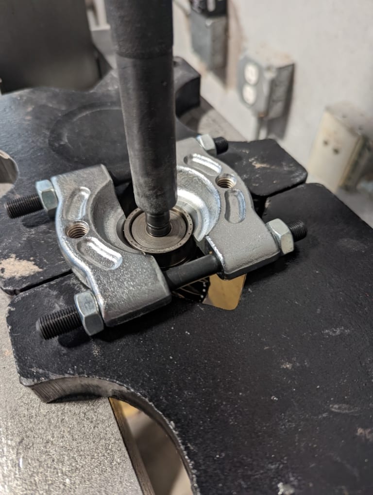

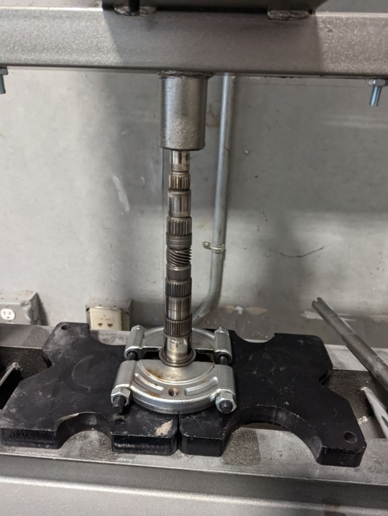

Next I took the circlip off the other shaft (input shaft) and then used the press to get 3rd gear and synchro off that shaft. No special tool required just used the plates that came with my press and snugged them out to the smaller gear and pressed down on the shaft which pushes the bigger gear off. I also added pictures of the tools im using.
I will probably get the taper bearings off the output shaft in similar fashion by taking cages off so i can get my tool on to that inner face and then use the press to get them off also.

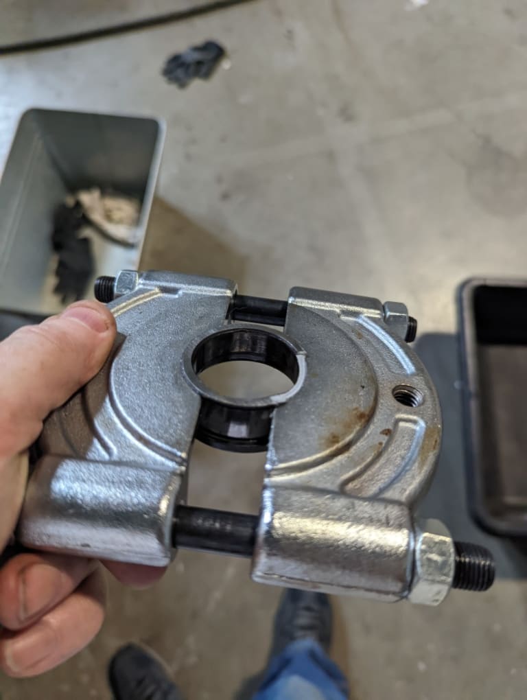

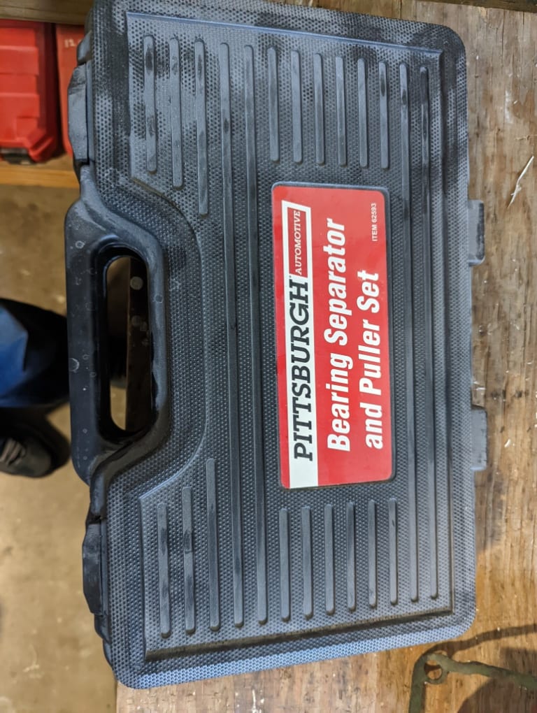

So like i said i didnt have the vw special tools so i decided to bust the cages off the bearings on the output shaft. Once i did that my bearing tool fits over them, i used the conical side of small bearing extractor tool i have. (which was not great because the contact is really only just four points because of the raise edges of the tool and size of the tool and bearing size, in hind sight i would probably use the bigger tool has a wider C-curve on each side of the tool) i then used the bar of a bearing driver tool just to space the gap between the bearing, the press pole was tool large to fit inside the bearing, then into the press with it. set it up in the press as shown. bearing came right off.
PXL_20220504_192701583.jpg PXL_20220504_192709683.jpg PXL_20220504_192924593.jpg
next had to do the inner bearing. It was a bit more problematic. Same idea though busted the cage off and setup the bearing extractor on the inside edge of the pouter lip. This time i used the bigger tool and also swapped to use the flat face of the bearing extractor tool so it would fit a little better……….more surface in contact with bearing. (Think i tightened it up a little too tight though) then set it up in the press as shown and bearing came right off. Last photo shows the cracked outer lip of the bearing, cracked half way through pressing the bearing off.

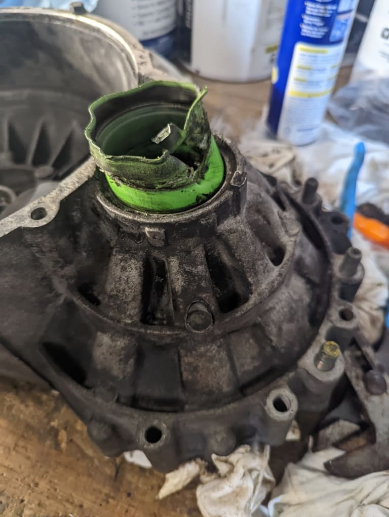

Forgot to add these. Had to beat the hell out of the green sleeve to get it out and to get access to the backside of the bearing to knock the bearing out. Once green sleeve was out used a 28mm bearing driver to tap the bearing race out.
Note: apparently those green sleeves are obsolete from VW but i managed to find some online fairly easily. But just a heads up for anyone just in case. Make sure you can get one before you go shredding the one you have.

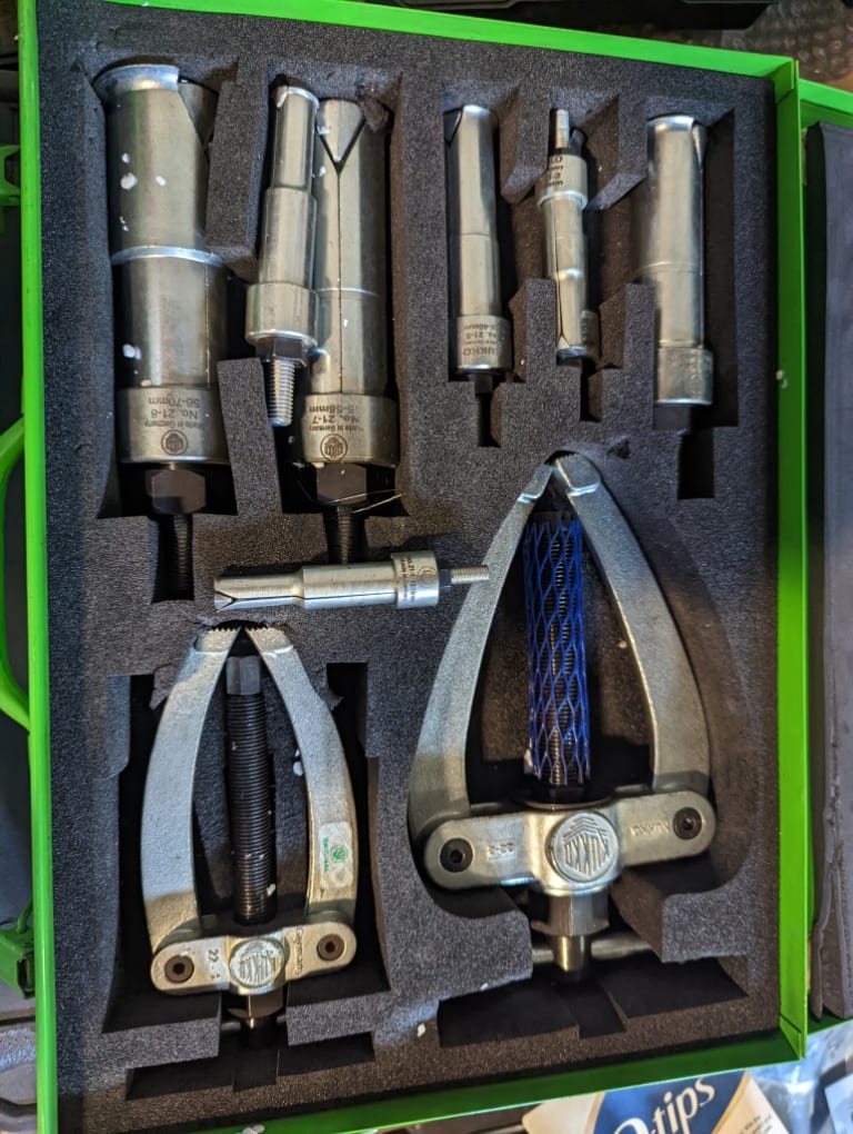

Paceman, quick update for you….. so my "new" tools eventually arrived. i bought the kukko 25-B set, (its pretty pricey, like $700 upwards for the set) so i did some digging and found a second hand set out of country for a third of the new price and low and behold it actually came with three additional pullers. so that was an amazing bonus! Anyway i used the 21-6 puller to get the shaft race out of the housing. See photos attached. I put the bearing cover back on the top so as not to damaged the aluminum housing with the feet of the puller. You have to align the puller with the half moon in the housing, its tight but Bearing race came right out no problem.
