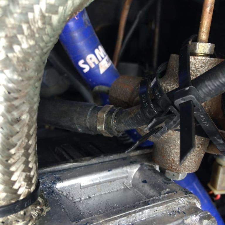

Hi all, Looked at a few old posts don't know if my clutch set up is correct I seem to get allot of movement in the cable and I have had to fix it using cable ties into position I saw on another post someone had done similar, why is this guys surely we shouldn't have to resort to this. Any help would be soooo appreciated please.

On my later cabriolet I have a plastic clip fitted to the brake master cylinder which holds the cable in place, thick wire works for me.

Okay I did replace the bushes in side the gear lever, I think from a bit of investigating the clutch wasn't fixed into position and it kept moving from its central position.
I am going to use wire to hold it into place and sort out the nut being at the top and making sure I have 10mm clearance.
thanks again guys let see what happens.
