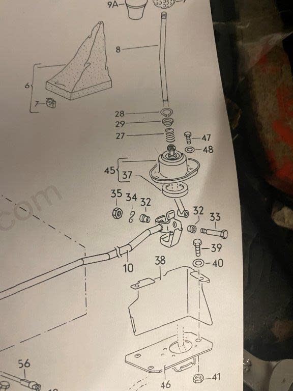

I suspect im being dumb but for the life of me cant get them fitted - specifically item 38.
Both parts fit inside the car (unless this is where im going wrong) and screw into captive nuts on the underside of the shell. I just cant see how item 38 fits on top of item 46 and still fit through the hole in the shell??!

mark1gls said
I think 38 (the exhaust heat shield) fits to the underside of the car?
I did retro fit one to my Mk1 Scirocco as it did not come with one, I think the fixings are already there as it did not fit from above..
I'll see if I've any pictures…
Thanks for confirming - the diagram is a bit misleading in that case! When i tried offering it up underneath the captive nut appeared to be in the way, ill try again.
